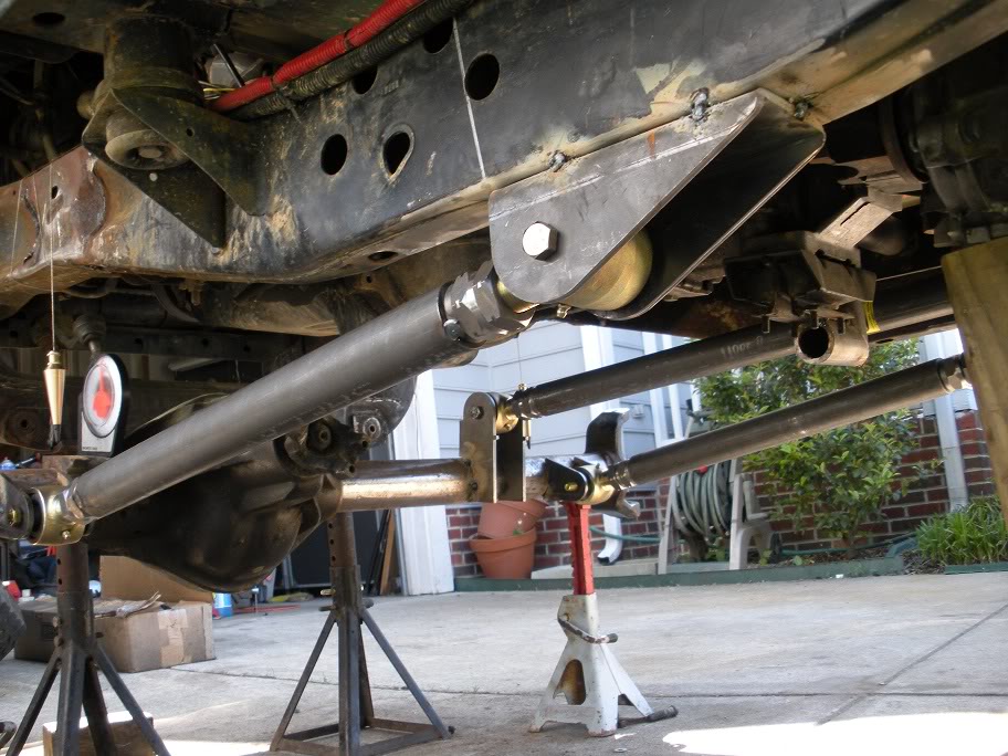

Ummm... everything I'm doing is thoroughly explained in my project write up thread...
But to answer the question, no, I am definately not doing that kind of suspension setup!!! That looks to me like its nothing but a glorified set of ladder bars, which SUCK! Ladder bars may be good for low-travel suspension like a race car, but nobody should have ever adopted the idea for a high-travel 4x4 suspension. The problem with them is they don't give you any control over the pinion angle through the range of articulation. 3 and 4 links do give you that control over pinion angle as the suspension articuates.
I'm doing a custom 3 link...

From the ground to the bottom of the frame rail under the door handle is 24 inches. Its 55 inches from the ground to the bottom of the door handle.
