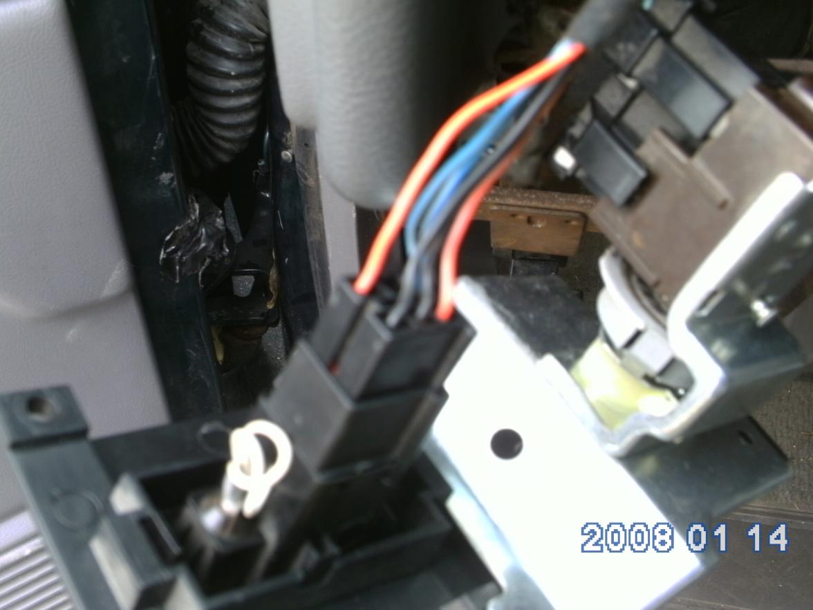

Both the switch and the pin 37 are showing a 5.13 resistance. ( The orange and white stripe wire showing resistance all other wires show .01)

Ok once again I screwed up...HERE is the DC readings with the red probe and black probe to a solid ground. 11.96 is the blue wires to the switch 8.88 is the orange/white stripe wire. 11.96 is the black wire/orange stripe wire
I just noticed u asked if I would test in dc
Then the top orange wire and the top black wire at the switch are giving no reading or a .04 reading No matter if I push the switch or not nothing changes except the Orange White striped wire.. When I press the switch the volts drop then go back up to 8.88
The 37 pin is giving a 11.96 reading in dc with the key turned forward. Sorry for being soo stupid...I hope this helps..
Pushing the switch also did no difference to pin bay 37 nor did it change anything to do with bay pin 55-56 both of the wires to the transmission switch are both putting out .04 reading no matter if you press the switch or not.

Alright... I'm not sure yet what kind of readings the various transmission harness wires should be giving... I haven't gotten that far yet.
But, the 12.4 volts coming out of pin 37 sounds about right. What should happen is that 12.4 volts should either be allowed to pass through the switch to pin 10 or should be cut off by the switch. So now check to see if its reaching the switch and then check to see what happens on the other side of the switch.
