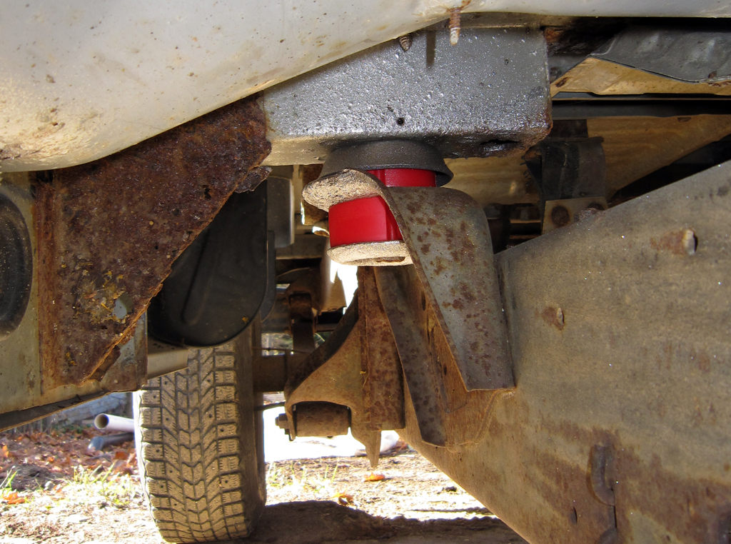

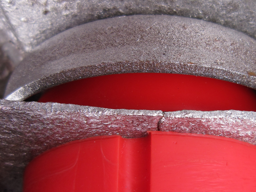

I installed 4 of the 6 bushing sets (not sure where the remaining 2 sets go... radiator core support?) I wire brushed all surfaces and sprayed with silver Rustoleum because the can says it stops rust. Here are the rear cab mounts:

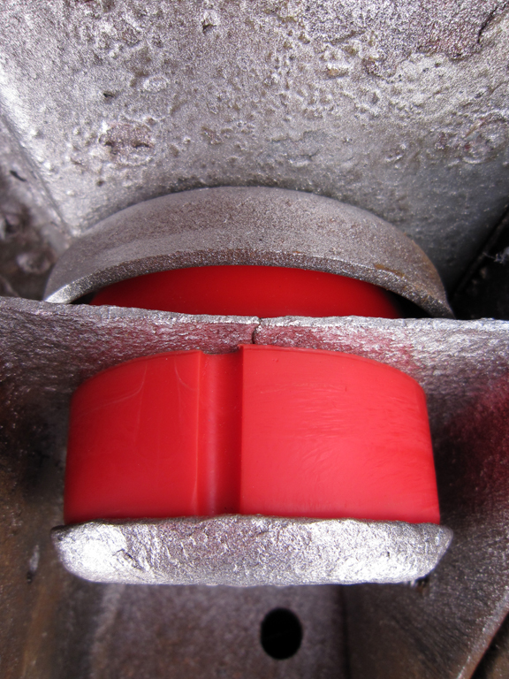

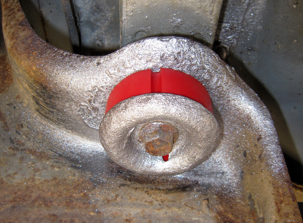

The fronts have a bad rust problem...look at the middle of the passengers mount it's thinner than the sides and cracked:

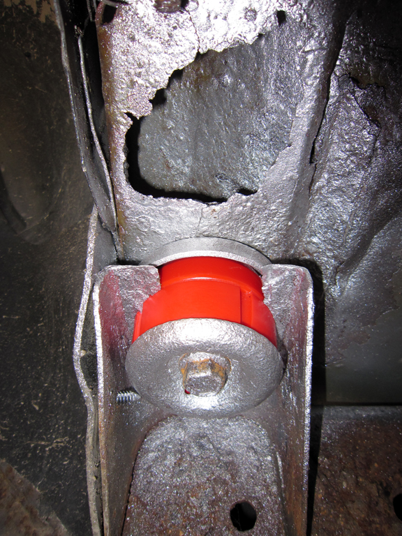

The front drivers side has a very bad rust problem which I am bummed out about, where the crack was on the passengers side is completely rotted out on the drivers side! Also as you can see there is a gaping hole in the body support...and when I jacked the body up with a 2x4 under the drivers side I heard a little bit of crunching and sure enough it pushed my floor pan in I hope the rust is not too bad under the carpet/rubber:
The polyurethane mounts might have been a mistake...they really do transmit the rough roads and tiny bumps BUT improve corners a little bit, all in all I should have gone with factory rubber which is probably more expensive and harder to find.

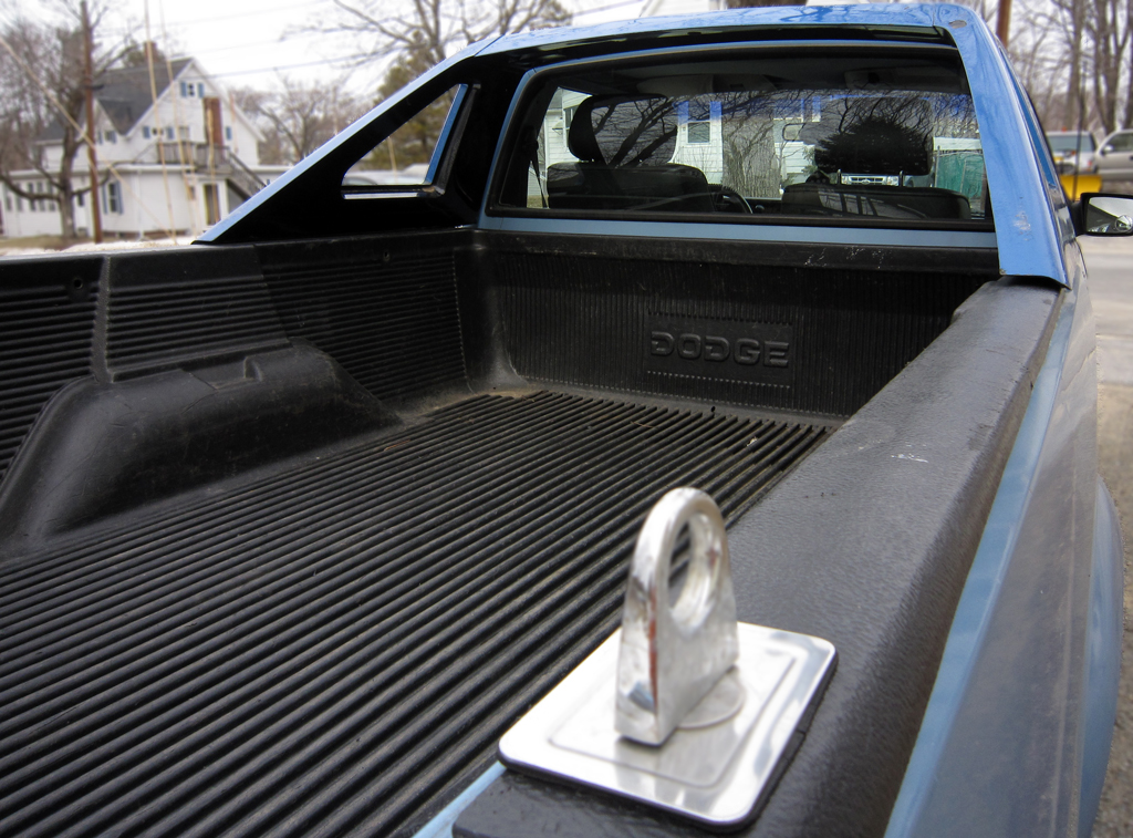

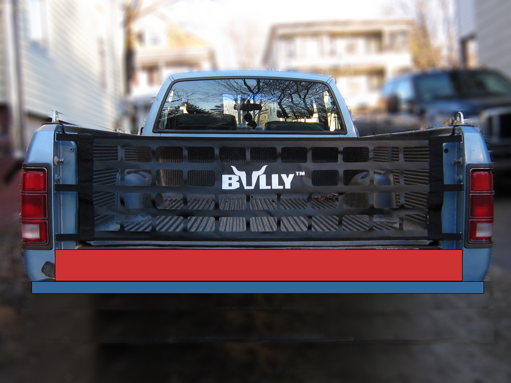

Picked up a tail gate net, I love the race car window net look. I will mount it as flush to the bed edge as possible, then drop that rear bumper...probably drive without one for 6 months lol.

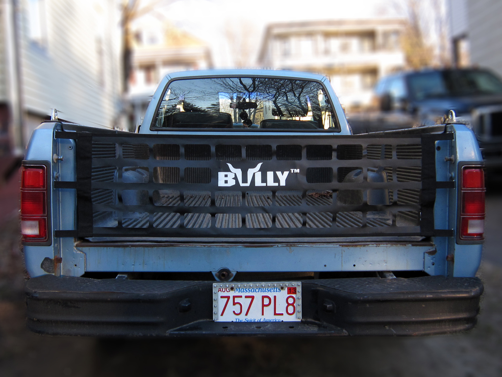

I installed the net completely flush with the bed line; like a tailgate instead of traditionally mounted on the inner tailgate rest/stopper:
If I don't sew a Mopar patch over the Bully I might put my licence plate there in the center of the net:
Makes it easier to backup in parking spaces:
I really like the look as well, kind of brings the front end together:
The red is where it needs to be boxed in since a roll pan only overs where the bumper currently exist, I need to compensate for the flap on the bottom of the tailgate...possibly weld a piece of bar stock to the top of a roll pan?
Now I need a visor, find a fast-back and locate the rarest of rare; rear window louvers!

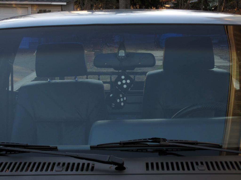

This is a 1990 spool with a tighter 1996 spring cap, with a black belt from a Mustang GT, Dakota guide arm, a male buckle clip from a BMW 740i for my seats, with the BMW seat mount sewed onto the end of the belt what a pain in the *** this setup was to create with all the trial and error lol Dakota's to my knowledge did not come with black belts:
I live above a seamstress she has nice sewing machines and knows her stuff so she was able to sew the Mustang belts onto the BMW seat mounts and with a stronger stitch then from the factory too, way stronger! This will hold even the fattest fluck from flying through my windshield:

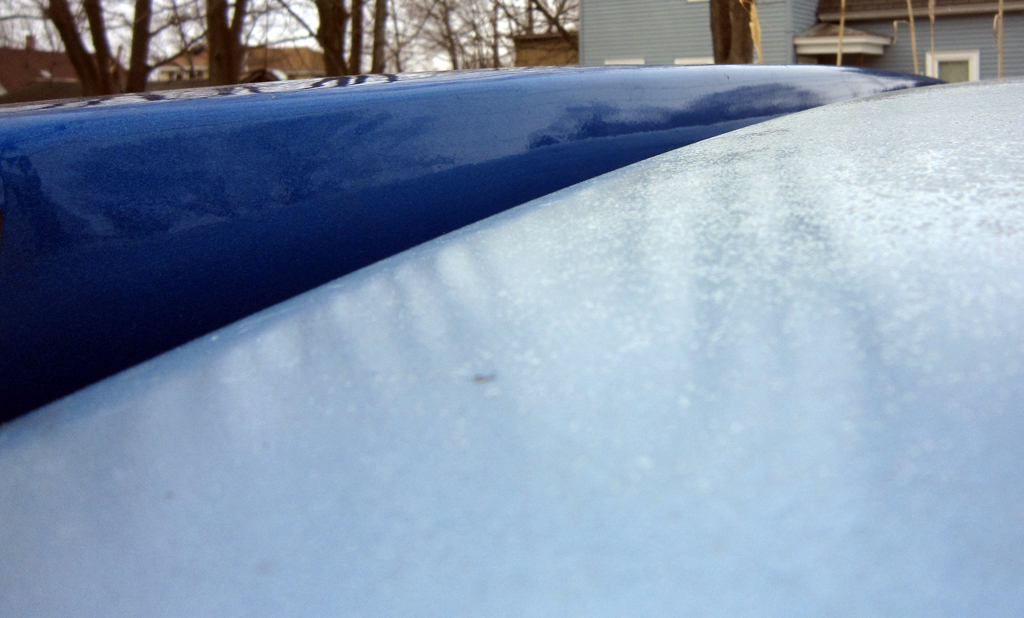

My searching is over, I have located and purchased an original 89' Shelby fastback for $150 shipped! It was originally white but someone had painted it, I got it from the user "moparnut38" now it needs to be sanded and primed:
It's just kind of resting on the bed for now, has not been anchored yet:
The top edge of the bed liner will need to be cut away for the fastback to fit flush with the roof line:
