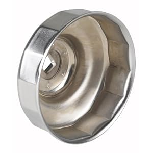

I have a set of oil filter removers that go on a socket wrench. The ex gave me the set of Xmas one year probably about 10 years ago. 3 piece set and one has fit every filter Iv'e ever changed and they work quite well.
Always do it warm so the filter has a chance to expand. When putting on the new one, don't forget to lube the gasket and hand tighten just till snug, then 1/4 turn more.
