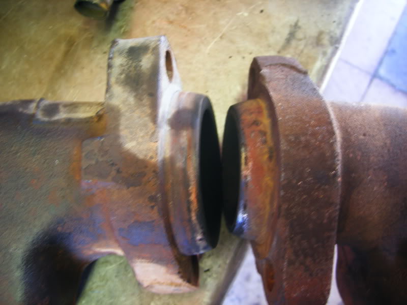

The problem I see is that they list those headers for 1992 through 1995 and the mounting flange for the Y-pipe is different between 1993 and 1994.
'92-'93 on the left '94+ on the right.
Since most places list their headers like this, it's the reason I'm hesitant to buy any because I don't want to get them, realize they won't work, and have to send the back.

Originally Posted by knoxy_14
I plan on going true duals do don't think that would matter right?
The '92-'93 have a larger flange because the outlet opening is 1/4" bigger. So it would be a shame to spend the money on a performance part and have it not flow as god as it could.
