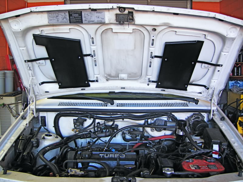

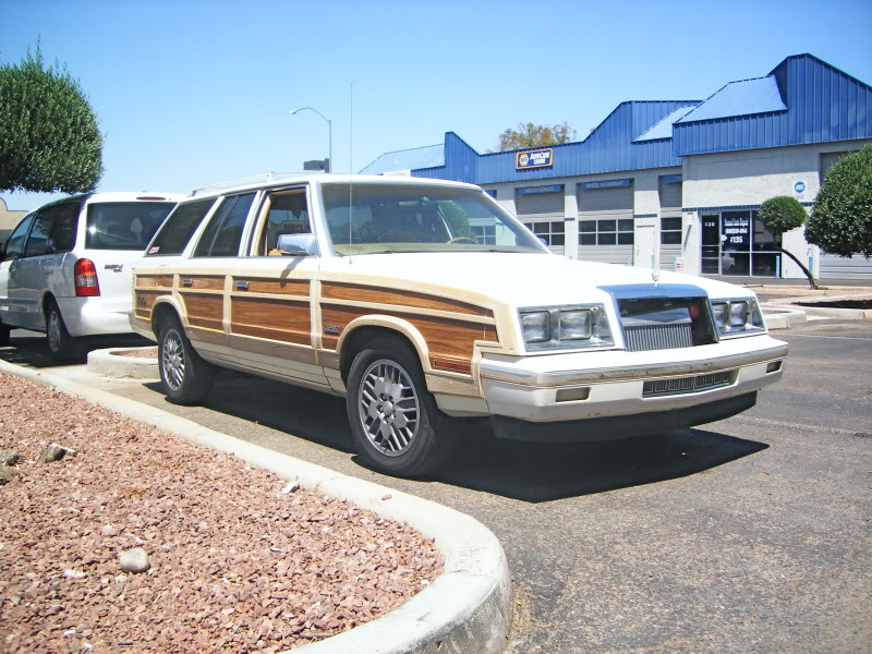

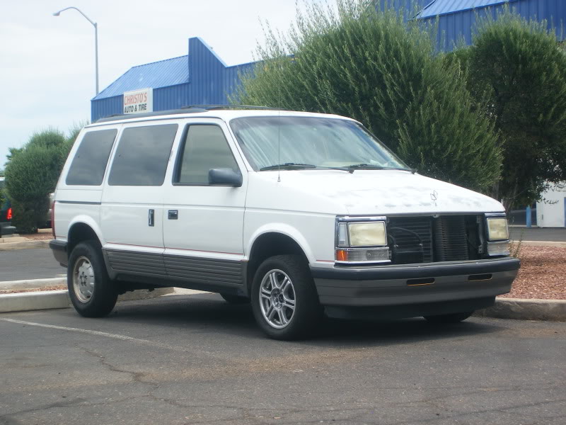

I have a 2.5 turbo engine in my '88 Dodge Caravan and I built my Dad a 2.2 turbo-charged '85 Chrysler T&C wagon.
My van ready for the track with the drag radials on, if it will ever stop raining on Saturdays so I can actually race.

My Dad's wagon.
