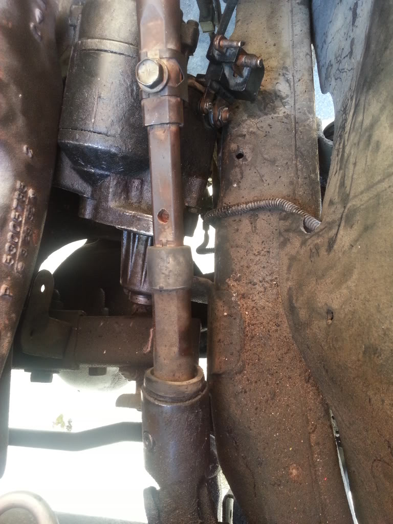

I removed the top bolt (see Picture) and the short shaft slides 1/4'' in each direction so I put the bolt back, at the bottom of the picture there is something that looks like a star or allen bolt, but i did not try to remove it. Let me know if this is what needs to be removed. Thanks

Old Sep 12, 2012 | 12:23 PM
Ben M's Avatar
Ben M
Joined: Sep 2012
Posts: 5
OK, I got it out by removing the fender shroud, I removed the tire and folded the flap down (took 5 minutes). Thanks everyone.
