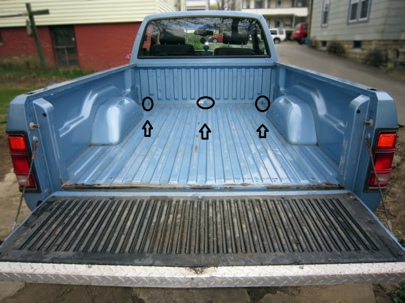

as far as draining there is two hole at the front of the bed that allow the bed to drain. if those plug up then the water will pool and rustout the bed or rain as you drive down the road(my favorite way).

I don't think there is on mine (1988)

the holes are in the upper corners and possible the middle that is circled in this pic of your bed. You might have to take something thin and hard too clean them out.

There are 2 small oval holes as stated.

What about with the plastic liner there are no holes in it?

as for the plastic bed liner....I have one in my truck and it dont have holes in it but than I have a hard cover on my bed so I dont have to worry about water getting in there. If anything just drill a couple of holes about a half inch in diameter in both corners of the front by the cab and try and get them close to the holes that are in the bed of the truck so it can drain straight down threw.
