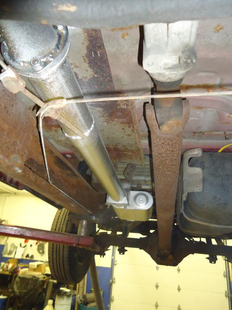

I've had this one for a whole two days already so the first order of business was to hang it on our rack here at the Tin Shack Garage and slam on a 3" exhaust mod using leftover scrap bits from old projects;
The stock 3" Y-collector got a flush cut and a new flange welded on in order to accept a scrap hunk with a 3 bolt flange welded on already. That flange stub then got stitched to a straight piece followed by a recycled flowmaster that got the 2.5" inlet whacked off at the taper for a 3" inlet butt weld. We left the muff outlet alone so we could clamp it to the existing 2.5" tailpipe that was installed by prior owner since it was in solid shape. Finally, I spritzed it up in a haphazard fashion with some silver bbq paint to hold off the rust for a little while. Since the parts were mostly reclaimed, the total investment was the cost of a 3" collector gasket, a few clamps and half a can of spray paint! Fun stuff from the butcher shop!
