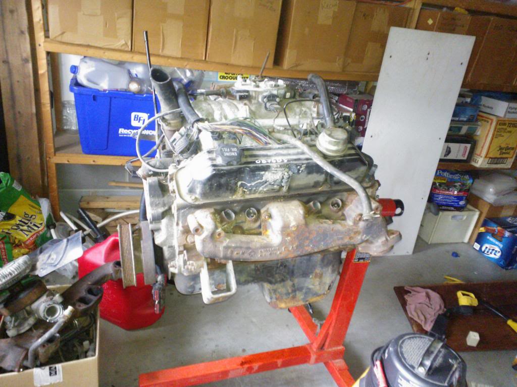

Yea makes thing alot easier to get to lol, also thats not algea on the motor just bad lighting in the garage
