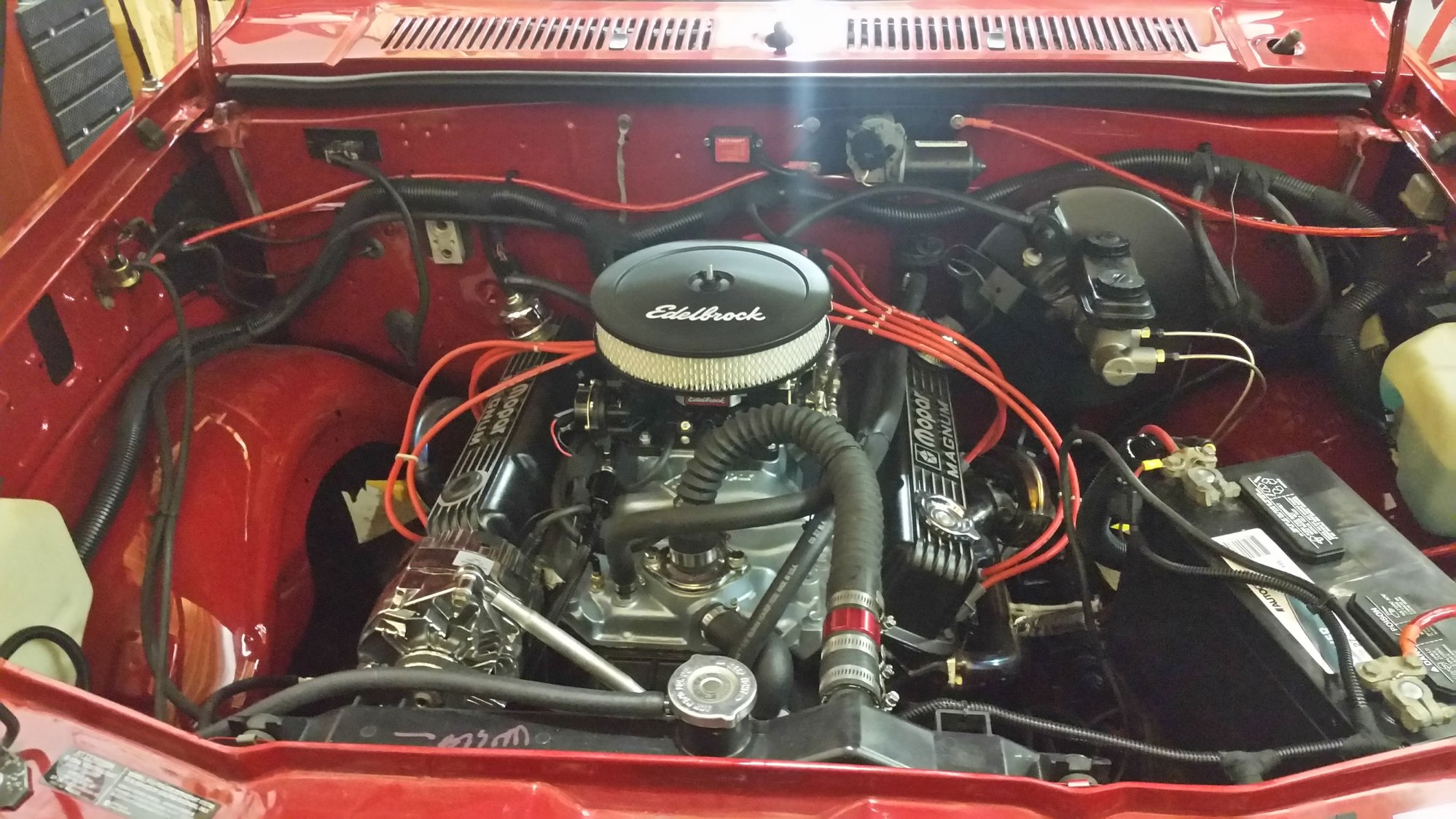

New Headlight Switch in, and all is working interior wise...and to answer an earlier question, yes the LED's dim...although it's not linear down to zero like an incandescent, but works fine.
Installed new Black Edelbrock Carb with electric choke to replace my 1405 and set timing...35 BTDC is what I'm running, using the manifold port of the carb.
Went to permanently install the wiring for the electric choke, and in the process was going to re-do my alternator +. Note to self, disconnect the battery next time. So, the big copper lug on my + alternator connection, shorted against the alternator housing, and before I realized what was going on, POOF....a nice big fire where the fusible link gave up its life. Fortunately, it did its job and only one other wire in the bundle was singed, so I'm waiting on a new fusible link (10 AWG). Yeah, I know I could have gone with a re-settable breaker or inline fuse, but I like the hypalon links. Old school.
Anyway, other things I did over the weekend:
Adjusted E-cable
Set timing, idle, fuel mixture - Running a nice -18 vacuum at 850 idle RPM, and 35 BTDC timing at 3000 RPM.
Set Rear brake drum pads
Installed drive shaft
Topped off Coolant and PS fluid now that engine and R&P are full
Topped off transmission fluid now that converter should be full...I'd modified the VB so that the converter fills in park, so all the testing, I confirmed that 5 quarts, there wasn't a drop in the pan, so it made it to the converter.
Lifted truck and Ran in Reverse and Drive...Sounded pretty good and no clunking in transmission or rear end...of course real test will be under load
Need to bleed brakes one more time as they are still a bit spongey for my tastes.
Need to replace fusible link and finish wiring in electric choke.
Need to clean interior and re-install seats.
Goal is a test run later this week if the weather cooperates then off to the muffler shop for exhaust.

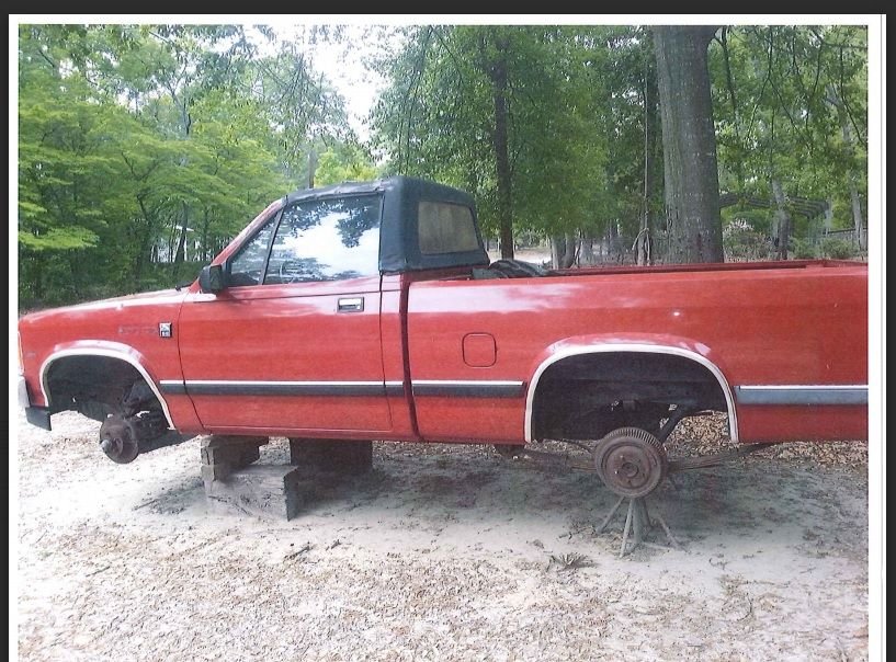

From this to this....you've come a long way baby...
Still to do: Exhaust on today...Top replacement next week
