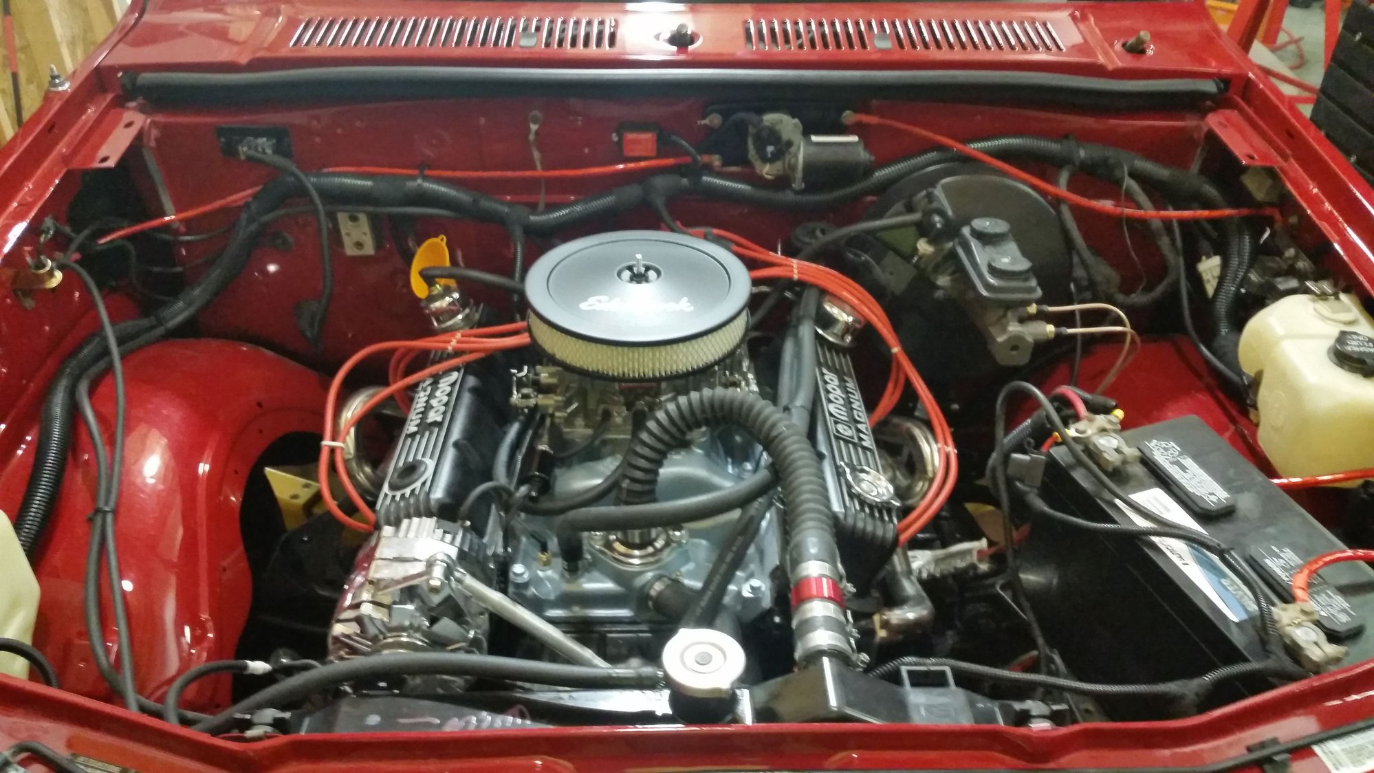

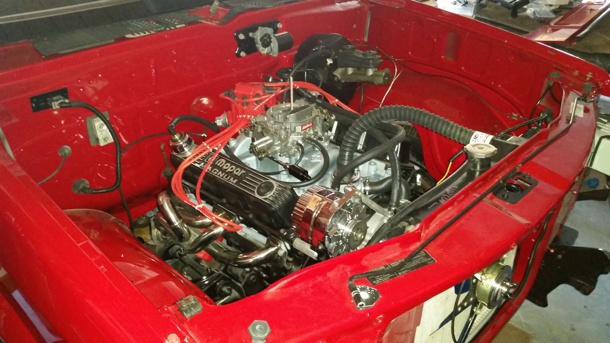

Here's a couple pictures of the wired up and plumbed up engine bay....Everything in electrical, vaccum, water, etc. except for the fuel line to the carb...I have to drill/tap some mounting holes in the frame for the psi regulator.

I cheated a little bit on the grounds....I bought a grounding kit that had the octogon hub...made for a nice termination point for the battery, electric fan, and frame/body grounds. Because the truck was newly painted I didn't feel like sanding down the fender mounting points to the firewall, so I ran the heavy duty ground straps to each fender, the firewall, the engine, the radiator core, the transmission and the frame. I did sand clean the individual points where the braids attach. I checked with a meter and I have 0 to .1 ohm everywhere on the truck that matters.

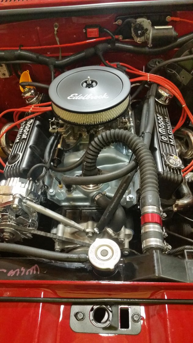

I have some body paint to touch up the bolt heads on the fenders...But you can see the 'old' red color compared to the 'new'

You'll notice in the first picture....no more computer...such a nice feeling
So, put in 5qts of oil, 3 gallons of antifreeze, 1.5 pts of power steering fluid, brake fluid in the MC, and 5 qts (of 10) in the transmission. Letting everything sit overnight to check for static fluid leaks...but so far so good.
Plan tomorrow is to mount fuel regulator and plumb in remaining fuel line. My oil primer rod for the oil pump came in today, so once I have fuel, I'll pull the distributor and valve cover, prime the oil, and rotate the engine twice. Once I've proven oil flow, I'll reset the initial timing, cross my fingers and fire it up. Let the converter fill up with tranny fluid and top off the remaining 5 quarts.
