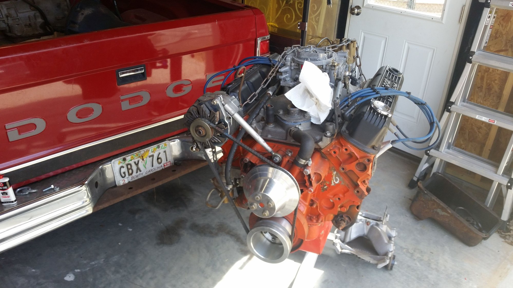

Geesh...Can't believe it's been over 2 years. Well I finally got the vert moved to my garage from storage. Started clearing out the engine bay today. A couple of pics of the engine bay, stuff and the new motor (still need to paint it).

Question:
As you can see, the AC manifold is still on the firewall. I don't plan to put AC back into this truck, so when I remove that manifold, what's behind it, and how do I blind it?
And what's the best replacement oil pan to use....You can see on the floor the original V6 pan, with the forward sump. No way the current pan will fit as the sump is in the middle.
