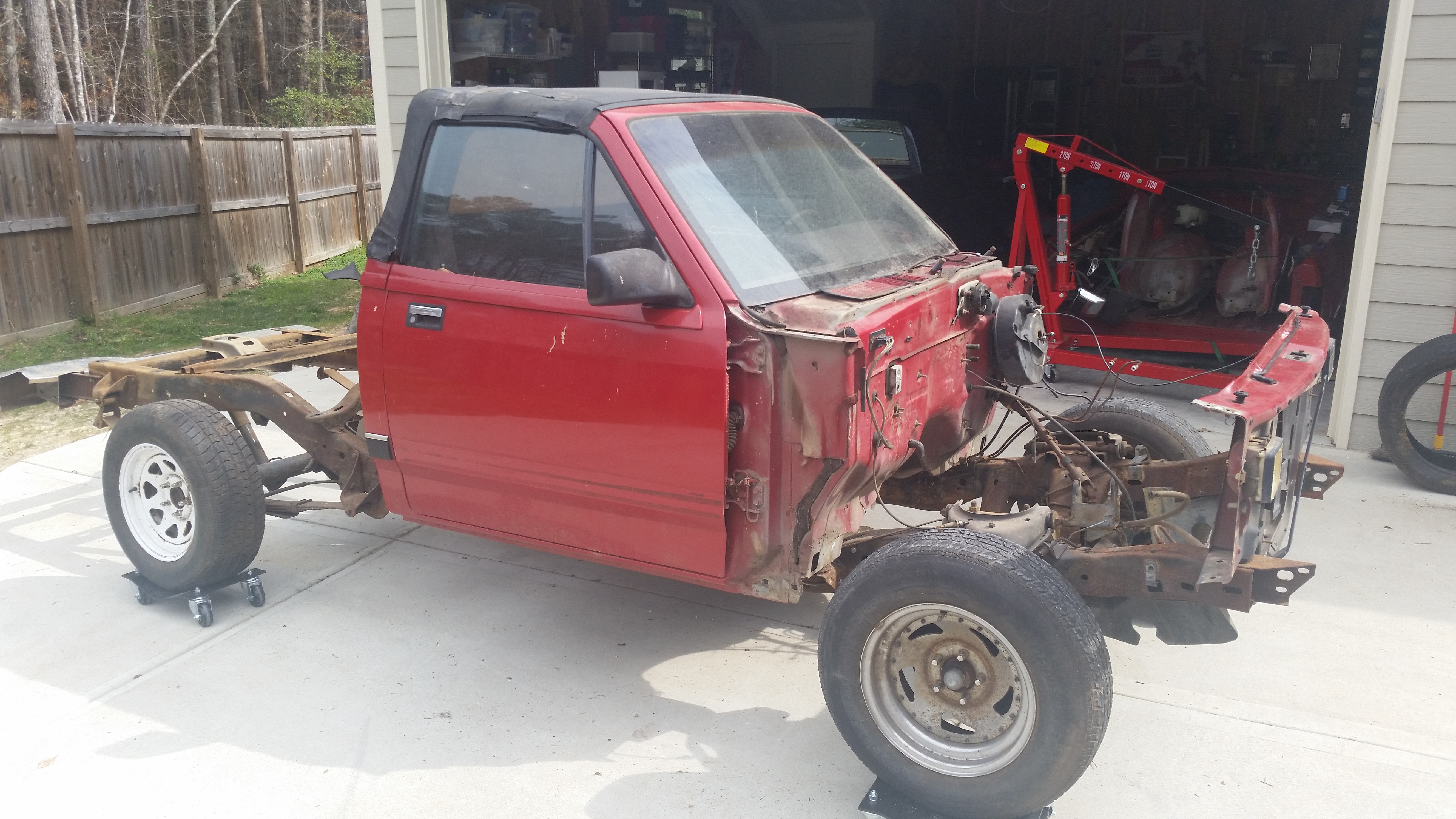

Thanks guys....here's a couple of pictures of her....have a shop down the road that's going to sandblast everything and POR the frame in a couple of weeks. Have until then to get the brakes removed as the rear drums are rusted tight.
