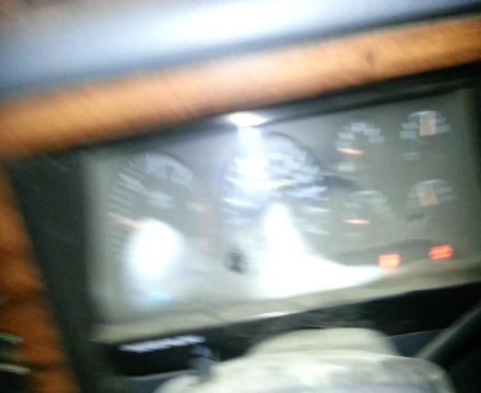

it runs great right on up until it starts to bog. i took a little video with my phone so its not the greatest but it gets the point across .. it revs to 3100 and its like theres a rev limiter on there ..

heres a video of it running first few revs are in park next few are in neutral
Attached Thumbnails could use a little help here-th_20140103_182334_zpsupq6zhis.jpg

If it only doing this in park or neutral. Then it maybe hitting the RPM limiter. Most of the newer vehicles do that now. How do the engine run when you are driving? If it bogs down, then I would look at the Manifold choke on the exhaust manifold. Is the power loss light or check engine light on?

it runs the same regardless ..

Check the exhaust and see if you have good flow or has little flow. You can also drop the exhaust flanges and run the engine or remove the o2 sensors. You could also have a bad speed sensor too.

at the moment the exhaust consist of manifolds to the cross pipe that runs both sides together into the cat. the previous owner cut off the exhaust after the cat.. i can put my hand buy the pipe and feel that theres plenty of flow coming threw so I dont think thats it.. were is the speed sensor located and how can i check it .
