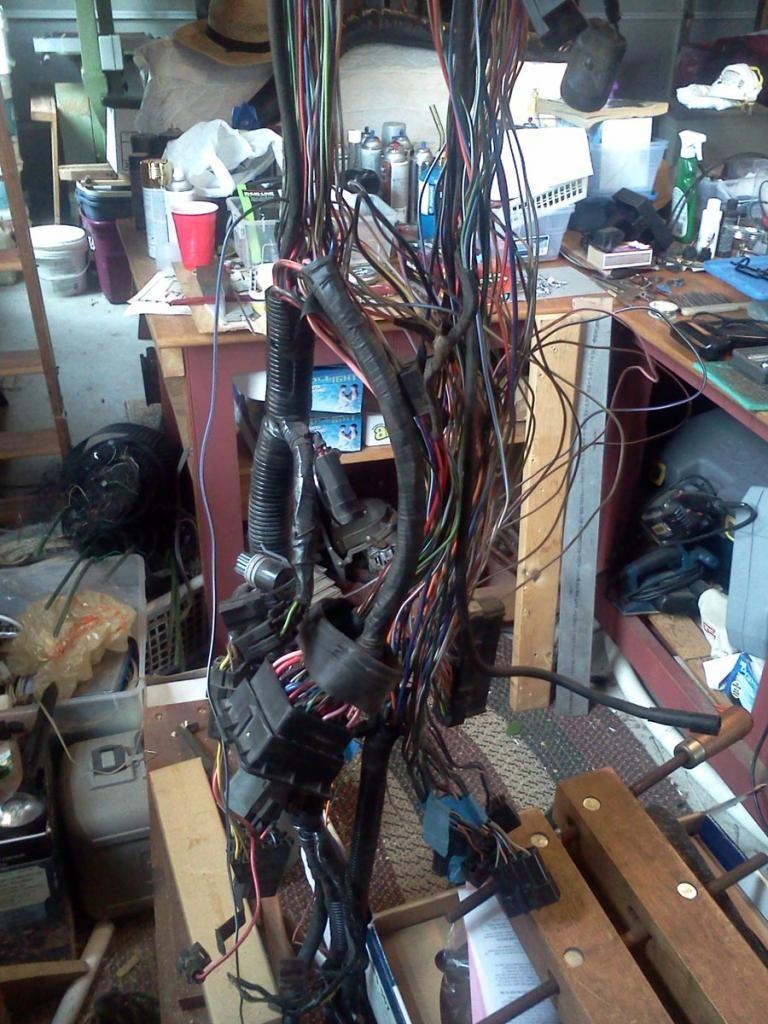

My engine wire harness was pulled from a ’94 Dak, but I also used wires from my original ’89 harness to add a few new runs to the harness as well. The Magnum engine bay harness is necessary because significant changes were made once Dodge switched from throttle body injection to multi-port injection.
Swapping a Magnum harness into an ’87 to ’91 Dak isn’t too hard, the bulkhead connector between the engine bay and passenger compartment is the same. You may have to add or delete a few circuits however. One major difference is that later Magnum Daks route some of the rear circuits, especially those for the fuel pump and fuel gauge, through the cab rather than going under the truck all the way.

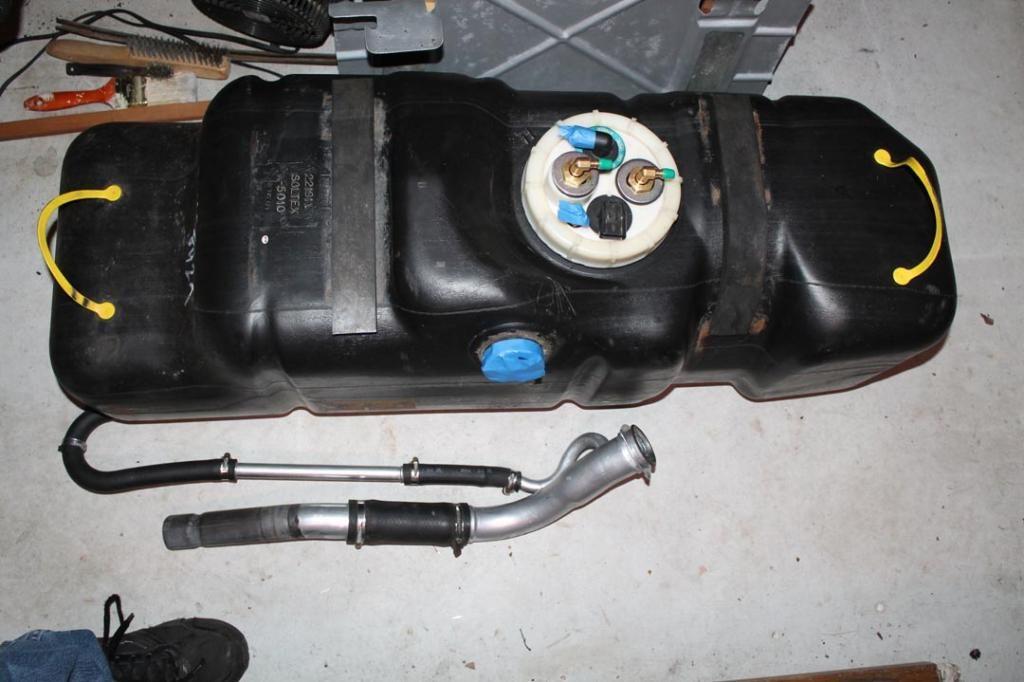

Speaking of the fuel pump, I also had to upgrade the ’89 pump to a newer model. Fuel pressure on the Magnums is higher than the throttle-body-injected Daks. I was going to purchase a ’92-’93 pump as I wanted to keep the return-style fuel system, but I also needed to find a later fuel tank since my ‘89 tank would not work with the later fuel module. After much searching I found a 22 gallon tank, with pump, from a ’94 Dak. The ’94 pump is a no-return type, but it wasn’t too difficult to modify the pump module for a return line. An important note here – all fuel hose used within the tank needs to be rated for submersion in gasoline. Hoses not rated for submersion will swell and disintegrate. The rating to look for is SAE 30R10, which can be submersed in gasoline and alcohol fuels. Also, if you need to install custom fittings to a fuel tank, as I did, be sure to use a good fuel-resistant sealant. I used Permatex Aviation Sealant.
My original metal fuel lines appeared to be in good shape so I didn’t swapped them out. The feed line is 5/16, which should be sufficient for my under 300 HP motor. Here’s some pictures of the modified ’94 fuel module and tank :
