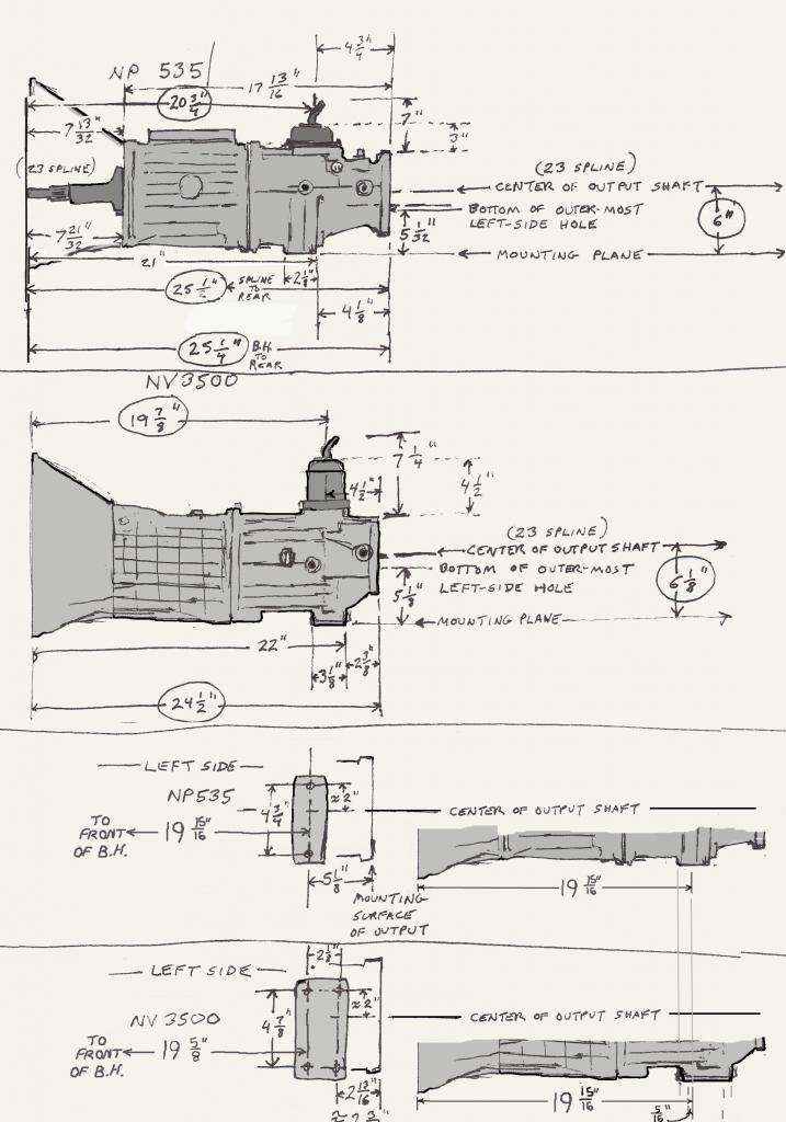

1. If I understand you used the orig. transfer case. Is it the same as the one used in v8 Dakota's?
Yes, I am using the original NP231 transfer case from my ’89 Dakota V6. It bolts up to the ’97 NV3500 I am using and it also accepts the original driveshaft. I do need to rebuild it first though. Check this, but I believe your ’87 may have a NP207 transfer case, which I read has a 21 spline input for manual transmissions, 23 for automatics.
2. What did you have to use in addition to the transmission, ie shifter, and if so did it come out of the floor in the same place as the 2500?
Nothing else really. If you use a NV3500, your best bet is to look for one from a gen2 Dakota, which shouldn't be too hard to find. The shift tower ends up in almost the exact same place as your original tranny. Even the old shifter screws right on to the new tranny! The original rear tranny mount will work, but you may need to modify it a little. The front pair of the mounts bolt holes will line up, but the rear 2 will be right at the edge of the mount, so you may want to weld on an extension. Avoid the NV3500 from a Ram 1500, the shift tower is located further forward.
3. Clutch hydraulics, what were you able to re-use there?
The original hydraulic clutch system from my NV2500 worked, I just had to trim the plastic flange on the slave cylinder a little, to clear the bell housing.
4. Did you have to change the driveshafts, ie, due to length?
That's one I'm still hanging on. I don't have the T-case or the drive shaft in the truck yet, but I know the new tranny is about 5/8's of an inch shorter than the original one, which obviously means a little less contact with the splines.
FWIW I plan to swap mine, (87 4wd, 5sp, 3.9 motor) to a 5.2 motor. But mine is carbed already from the factory, so I plan to use a magnum 4bbl intake, 600 cfm carb, and a standard HEI dist.
Is your 5.2 a crate engine? You're going to have a lot of fun! There's not a lot of info on doing these swaps for a 4WD, but it's really not too hard.
Thanks again for the write up
There aren't many folks interested in my obsession around here, so its great having a place to share it! I will post a drawing I did that compares the dimensions and mounting points of the NV2500 and NV3500. It may be useful to you, if you can read my scratchy writing. It's not to scale, and the measurements are probably only good to about a 1/4 inch, but it helped me quite a bit.

Some dimensions (rough) for the NV3500 & NP535 (NV2500):
[IMG]
[/IMG]

I printed out your drawing to make sure I don't loose that. I have not purchased a motor yet. I found one out of a jeep that I want to look at. My orig. thoughts were to re-use the nv2500 and 207 transfer case for now. And be searching for a 3500, and as you said, my transfer case is going to be the wrong spline. So I will need to look for that as well. I would really like to keep the mech. speedometer. Not sure what year they switched to electronic, and if it is possible to convert the newer transfer case to mech. drive.
But back to the motor, I think, I can reuse my v-6 flywheel. I will be going with a carb intake, so I wont need any sensor feed back from the flywheel. Any advise you can give me will really be appreciated.

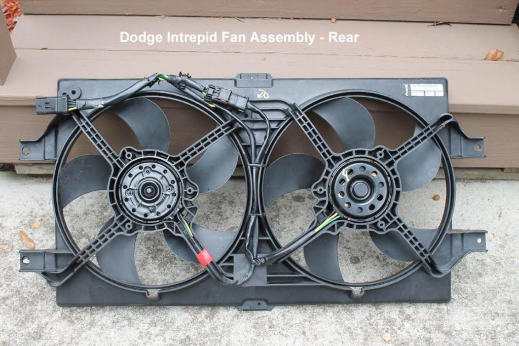

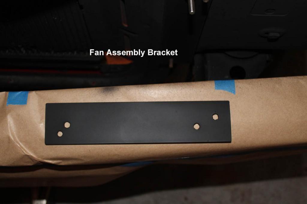

I've finished the bracket plates that will hold the electric fans in place. The brackets will bolt up to the existing studs that supported the AC condenser on either side of the radiator. I try to avoid drilling new holes in the body as much as possible.
The brackets are made from 2 inch wide by .125 inch thick aluminum flat bar, cut to length and sprayed with an epoxy paint. Fasteners are 1/4 inch stainless.
[IMG]
[/IMG]
The Intrepid fans mount on the engine side of the radiator in their factory location; "puller" style. Due to the space limitation in a Gen1 V8, I'll be placing them in front of the radiator; "pusher" style. This image shows the fans from what will be the intake side:
[IMG]
[/IMG]
Same fans from the exhaust side, which will be toward the radiator:
[IMG]
[/IMG]
