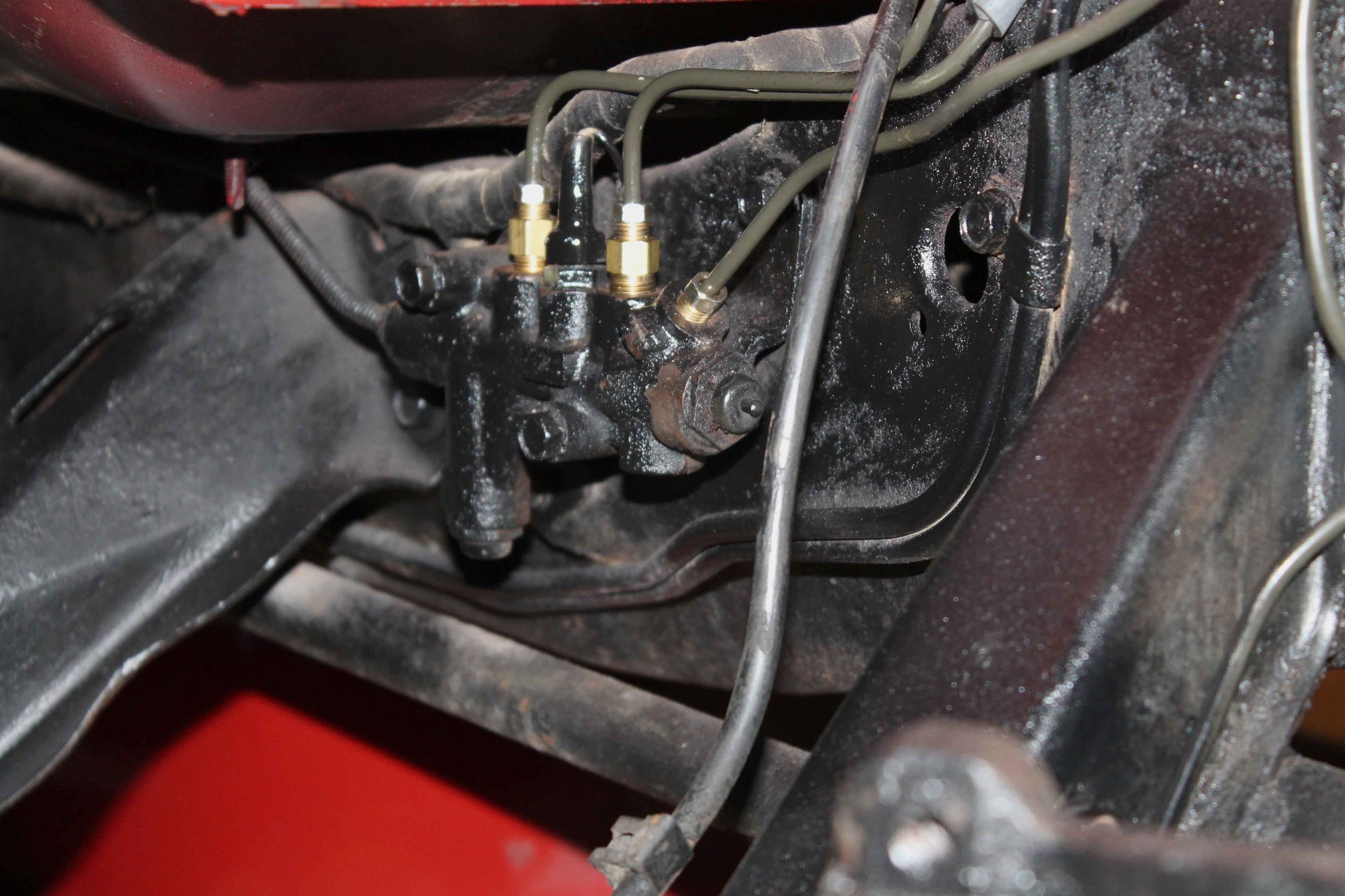

Here's the adapters I used on the front combo valve. The connection I'm having problems with still has the old line on it. It's in the rear in this picture:

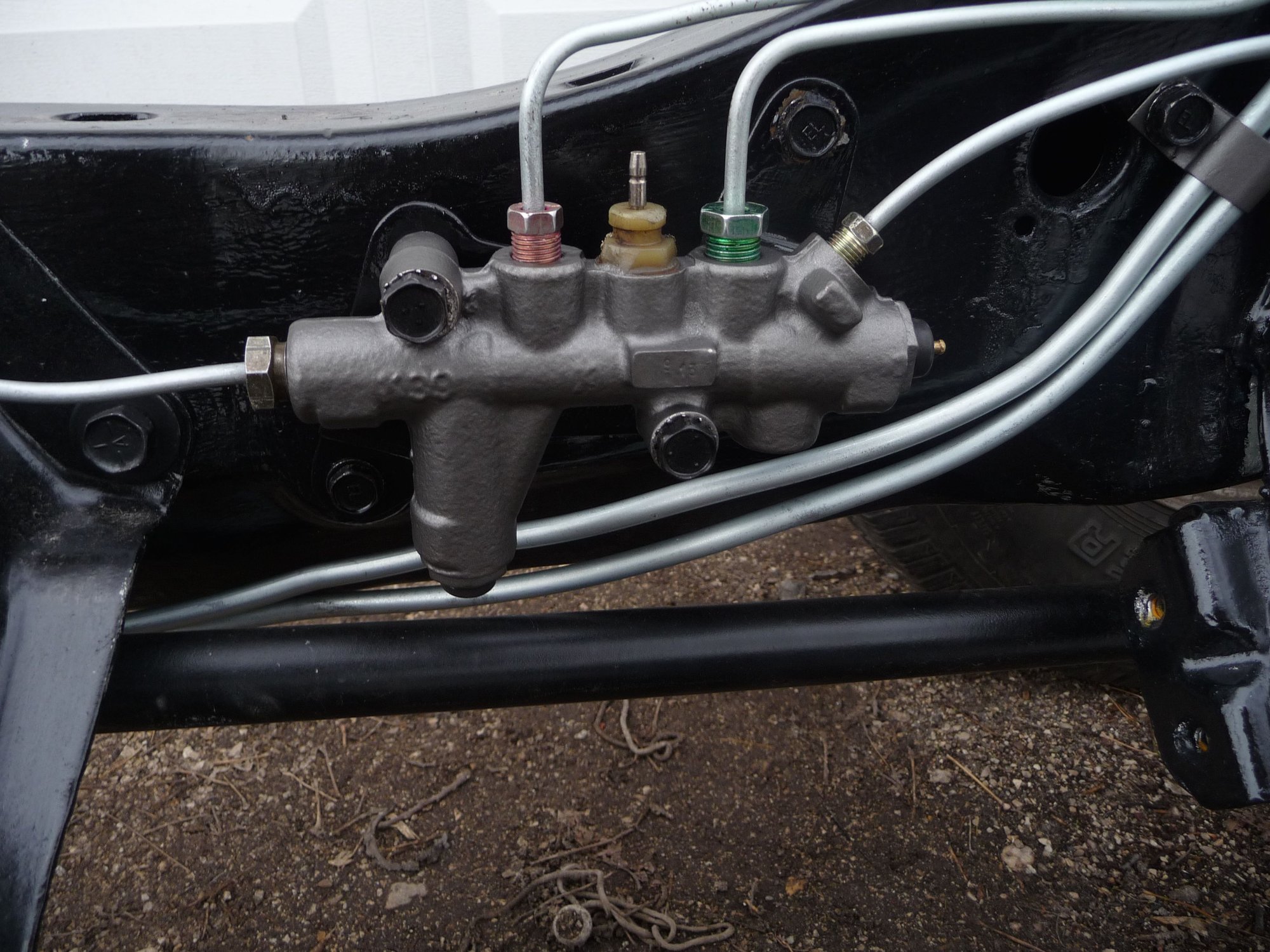

Every fitting is new. No adapters used anywhere.
I made new lines from bulk tubing and flared them myself.
Gen 1 Dakota Brake Valve

That's a clean-looking job, you really cleaned things up nice when you did your frame resto. Wishing I had just gone the bulk tubing route now, and done the flares it myself. I thought I was doing a good thing by using the factory-made flares, as I wasn't too sure I wanted to rely on my first-time attempt to make them. Where did you get your double-flare tool?
