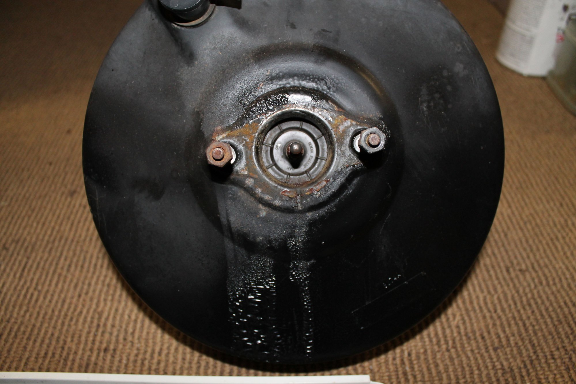

Guess I knew this was coming; was about to bleed the brakes a couple weeks ago and noticed a trail of fluid and loose paint on the brake booster, under the master cylinder. I wasn't sure how old the master cylinder on the truck was, but apparently it was old enough to rupture a seal after it sat up for the last few years. My plan was to use the original master cylinder and booster if there were no leaks; just clean them up and re-paint them. But now that the master cylinder has failed, I decided to replace the booster as well as the master cylinder, since those were pretty much the only brake-related components that weren't replaced in this rebuild.
The toughest part of replacing the booster is getting to the four nuts under the dash and above the steering column. The easiest way I found to reach them was to use a half-inch drive ratchet with a deep 1/2 inch socket, a universal joint, and a long extension. With the knee bumper plate removed from under the steering column, you can reach in, threading your extension thru the wiring harness. I was able to get all four of them this way. A good light helps too.
If you ever see this kind of leak between your master cylinder and booster, you've got a ruptured seal. If the leak is bad enough, and goes on long enough, fluid could get into the booster as well. Brake fluid is corrosive, so you don't want that to happen. If you think the booster may have fluid in it, my advice is replace it.
The rebuilt master cylinder and booster I bought came already paired up, but you have to separate them so you can bench bleed the master cylinder prior to installation. I'll be doing that soon. The booster had no paint on it, just a clean, blasted surface, so I primed and painted it.

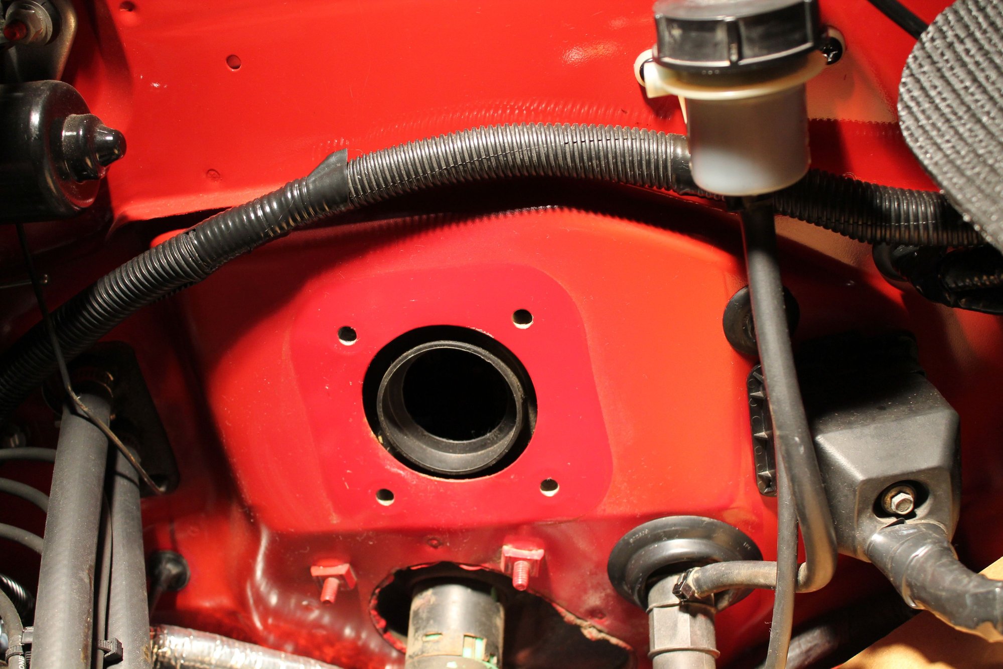

Here's the hole in the firewall where the booster mounts. There's a foam gasket that goes in between the booster and firewall but my new parts didn't include it. The old one looks workable so I'll re-use it. I did get a gasket for the area between the booster and the master cylinder, which strangely enough, my original set up didn't have.
