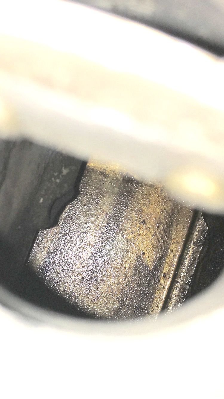

Yesterday I was given a free 1992 Dodge Dakota LE w/ the 3.9L v6 engine. Great. Lovely. Its been sitting for four years but it runs and drives. SO i'm new here and I'd love some help.
I want to restore this car back to its former beauty and any help is greatly appreciated.
- 1. My exhaust is blowing white (almost blue. almost.) smoke like no other. its also dripping gas from the exhaust. Any ideas on where to start fixing this. maybe #2 will help.
- 2. Its carbureted. I've looked on teh forums and don't see other 92 dakotas with carburetors. The guy that gave me the truck was the first owner and he didn't do a conversion to the carburetor. Yet here I am with a Holley carb (neato).
- 3. I've seen this issue on a few dakota forums now....why the hell does the hood stick? I did the whole pull the lever and bang on the hood trick. It worked but it's not my preferred method of checking under the hood.

First of all to start you do not have a carburetor, you have an electronic fuel injection. The throttle body only controls air unlike a carburetor which controls air and fuel. The Holley throttle body is stock, not a performance piece.
First step is to clean out the air filter box and tube, looks like it is a nest of some sort on the inside. Next will be to look down the throttle body with a flashlight, check to see if you find oil at the bottom of the intake pan. If so then the intake plenum gasket is blown, which is pulling oil from the engine, which would be one possibility of the smoke.

Welcome to DF. What Crazy stated above is a good place to start. Clean that air cleaner out real good, give it a tune up, plugs and wires, change the oil and filter, new air filter, and check the plenum as stated.
Another vote for the plenum issue, those symptoms suggest it. It's a well known issue that happens to some (though not all) of these motors. The fix involves pulling the intake manifold to get to the plenum pan/gasket. It's not to difficult if that proves to be the problem.

A good tuneup (wires, plugs, cap, rotor, air filter, PCV valve, PCV air cleaner if it has one) is highly indicated, as well as checking to see if there's oil in the bottom of the intake plenum (since that's one of the signs the plenum gasket has failed on the 92 up motors.)
As to "dripping gas out the exhaust", verify that's not just water because it's cold enough to condense as the motor's running (that tends to take care of itself by running the motor enough).
