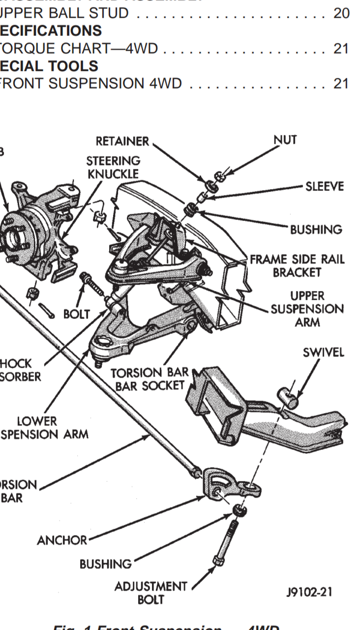

The bushing on the rear side of the cross bolt is the one that is worn out. Should i change the whole upper arm or just that? Maybe im gonna go to a junkyard and swap out that whole assembly.

My suggestion? Yes. *grins*
Go to the boneyard, grab both upper control arms, and rebuild both with bushings and ball joints.
Then swap both out in one weekend.
Get it aligned, and at least the UPPER control arm should be good to go for several thousand miles.
