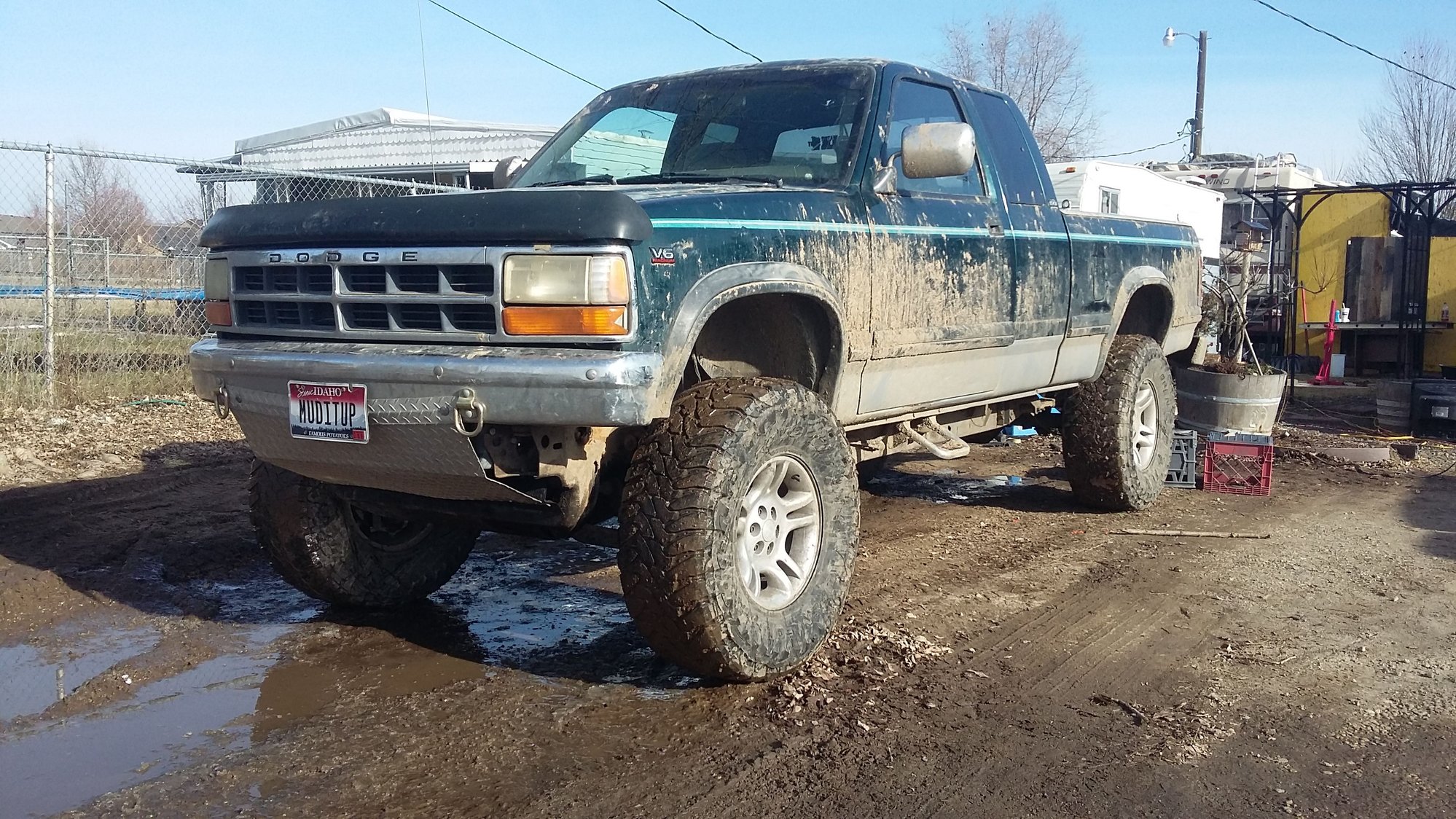

BTW I like the picture of your truck. Looks good raised up with those tires!!

Nice truck! The NV3500 is a good transmission. Looks like a fun project.
