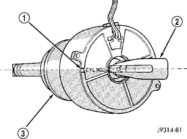

You mention backfire, Is it out the exhaust or the intake? This is what is in the factory manual for the fuel sync. Keep in mind this is not for a motor that has wear, That's where the scanner comes in to see where it is. I don't think that is your issue though.

On the fuel sync, when I had it at TDC 0, that is pretty much where the dis button and plate marking were aligned, exact? little before or after? that I couldnt say. I plan to check all of this in detail maybe this eve if I get home in time to do any sort of shop tinkering.

I took the time this eve to check the fuel sync manually....may be on to something. It was a bit out of wack so tried to set it to the recommended +3 but it ran even worse. So backed up and set it as close to zero as I could do by eye. Now it revs maybe 70% of the time but still has that down throttle back fire. While in there figured I would test the Pickup coil I have again. It does toggle from 0 to 5vdc when the engine is turned over, but In doing so using the FSm I noticed the following.

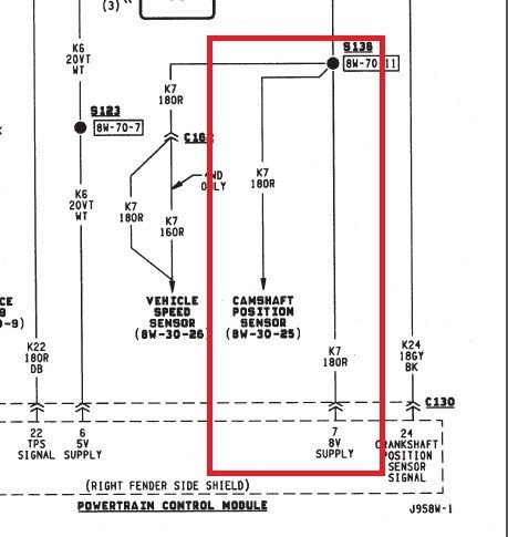

The FSM clearly shows that the inlet VDC to the pickupcoil is 8V based on the FSM schematic. Thought this might have been a typo but I see that many things show a 8v feed where others show 5v. However on the inlet to my coil I only showed 5v in and 5v out....wondering is this 5v vs 8v might be an issue.
I ran out of time to backtrace the source voltage, but unless I find some corrosion resistance figure I'll find 5v at the PCM. I do have a new pickup coil on the way, so will not make a rash decision on the PCM based on this find until I show that the new coil does nothing.

It's a typo unless your manual is from a newer year. I checked it with mine(96 ram truck 1500-3500) and both crank and cam sensor use a 5 volt supply voltage. Actually all the sensors use it for feed back to the pcm. Either way if you didn't have feed back to the pcm it would not run at all. Can you get it to back fire in park or do you have to have it under load?
