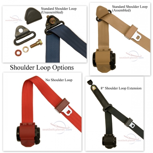

Where did all the honest people go? The picture which is one of the pics showing the harness on the page I bought it pretty clearly shows a 1/2 bolt and hole. This thing seems like the whole triangle is less than half the size of what that picture shows. The bolt is fixed in the hole with some sort of washer it isn't separate like the picture shows either.
