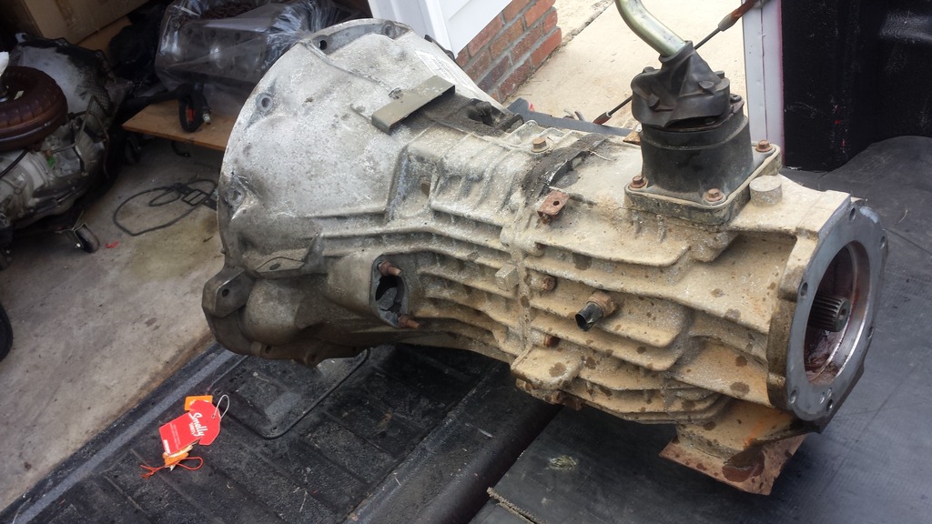

I have a NV3500 setting in my garage. Here is a picture of it. Oh and its out of a 04 dakota with a 4.7 engine
If any additional pictures would help, let me know. BTW the shifter is on backwards.
