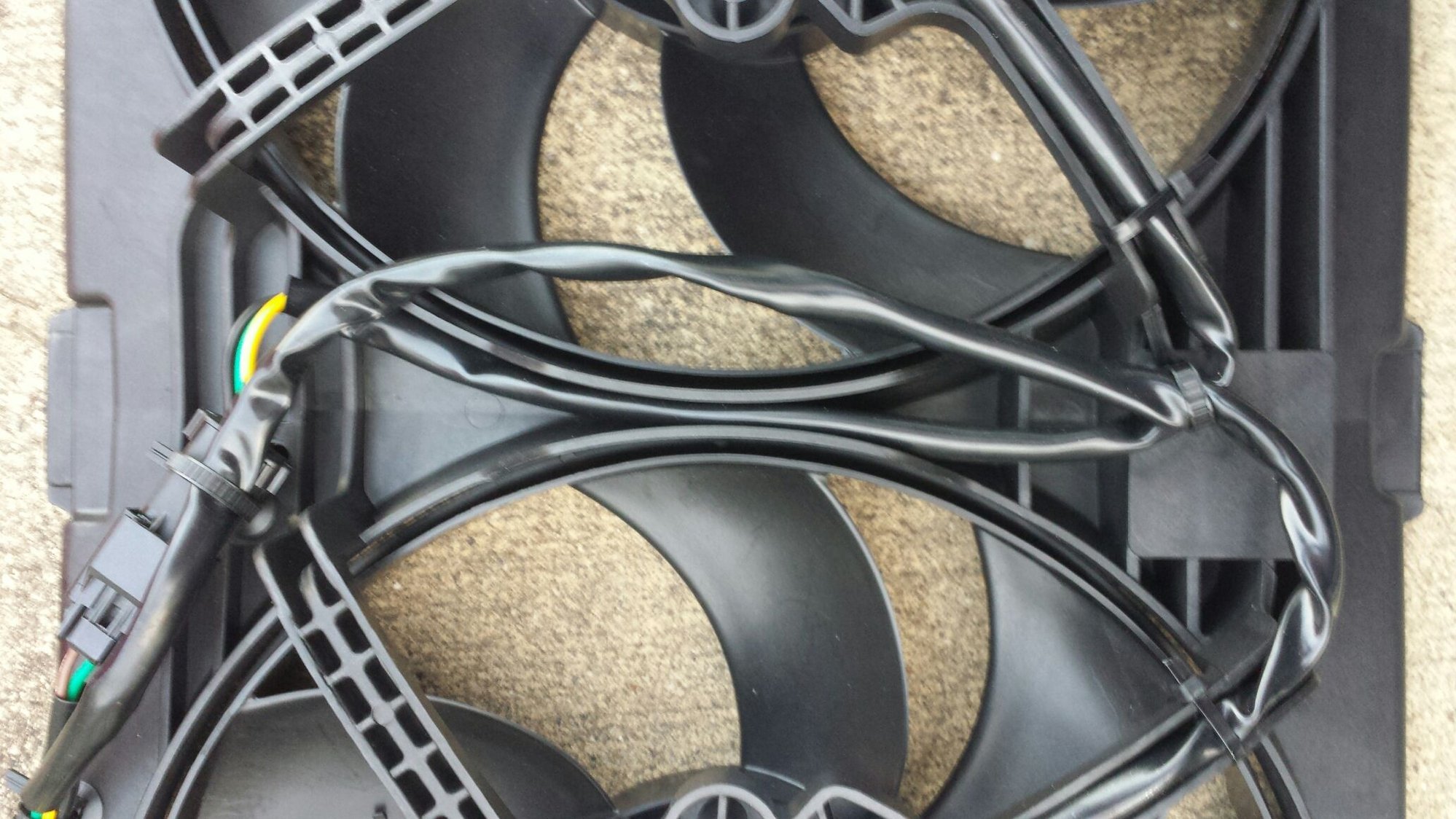

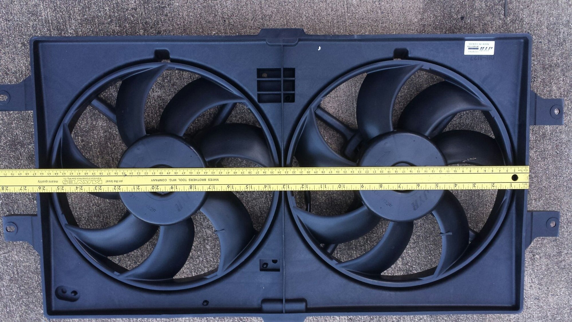

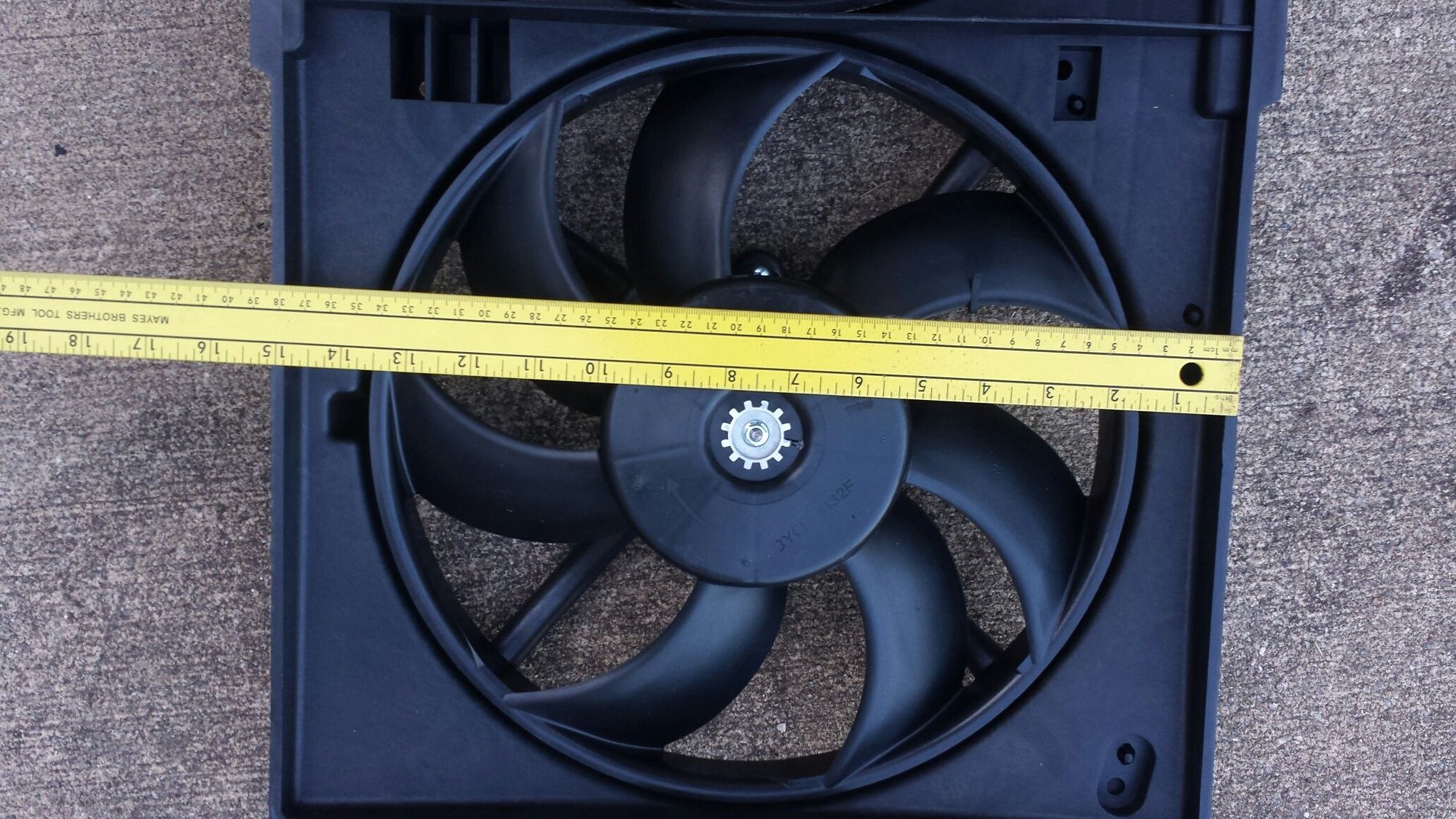

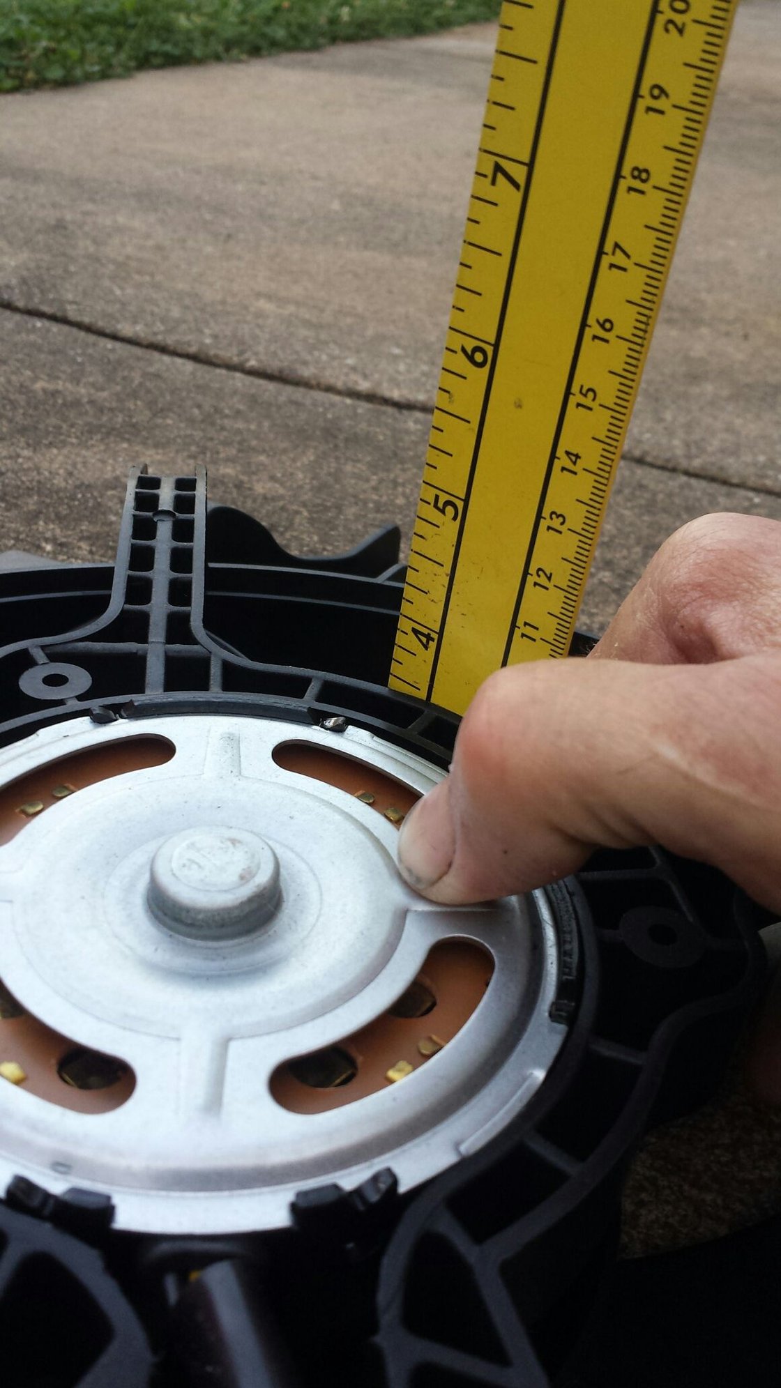

Hey Robert Here are the pictures.
This is the box, Got it off of ebay.
This picture shows width
Here is the height
Here is the center, and I believe the wiring could be re-routed and this cut down to 2in.
Here is the motor height
Here is a picture looking straight down
When I purchased this, my hopes were to sandwich this in between the condenser and radiator. I have not pulled the radiator to confirm measurements, but I believe the distance between the radiator and condenser, at the top is 3.5 in.? but less at the bottom.

That's about right...it's definitely tighter at the bottom. As an example, on the 91+ core, my permacool bracket that I fab'd actually sits in the lip of the radiator at the bottom but is a good 3" away near the top. The 87-90 core is similar as if you look at the inside vertical support for the grill, it has a dog leg at the bottom that kicks it out to match the top.
As for installation and measurement, it's much easier to remove the front grill and headlights to access that area than removing the radiator....I did it about 4 times in the past week.
Thanks for the info on the intrepid fan. Yeah, that's an early model intrepid fan....Most of the hot rodders use the 98-2003 which is much larger, so that had me confused.
Today, I installed an Imperial flex fan. I decided against the flex-a-fan as it is aluminum and only 4 rivets hold the blades to the hub...and the hub isn't solid. The imperial is solid steel and one piece so much stronger. 6 rivets hold each blade which are also steel, not aluminum. The horror stories about the flex-a-fan's breaking apart and sending shrapnel through the hood was enough to steer me towards the imperial. So far, so good. I let it idle for about 20 minutes and the temp never got above 1/2 way. The electric fan did kick on at 150 deg but it took awhile. The temperature differential between the top and bottom of the radiator is now closer to 35 degrees, vs 20 degrees before. Going to drive it around town and cross my fingers.
