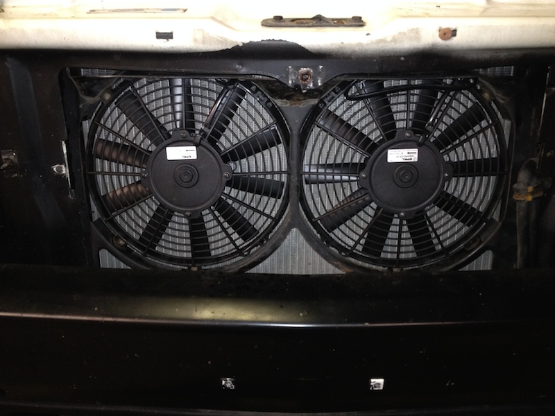

With this 100 Deg heat, my 90 vert with the 360 magnum isn't staying cool. It will slowly climb over time. I have a 3000 cfm pusher fan and a standard 5.2L aluminum/plastic radiator I pulled from a 94 Dakota at the J/Y. The radiator looked like it was a recent aftermarket replacement so who knows the spec's. Any suggestions for a higher capacity radiator that won't break the bank? A 4 core perhaps?

The fan I'm running doesn't have a lot of interference like some grilled fans. It's a perma-cool: http://www.code510.com/high-performa...iABEgJXLfD_BwE

Both at Idle and going down the road. Idle a little worse as the fan obviously doesn't cover the entire radiator and I've read that you really shouldn't run a shroud on a pusher.

Edit to add this picture
This is a factory fan on a shelby. My understanding is they were I think 11in and moved about 1200 cfm each. They dont cover the entire radiator, and they pulled through a condenser as well. In short, I dont believe its your fan not covering the entire radiator causing your problem.
