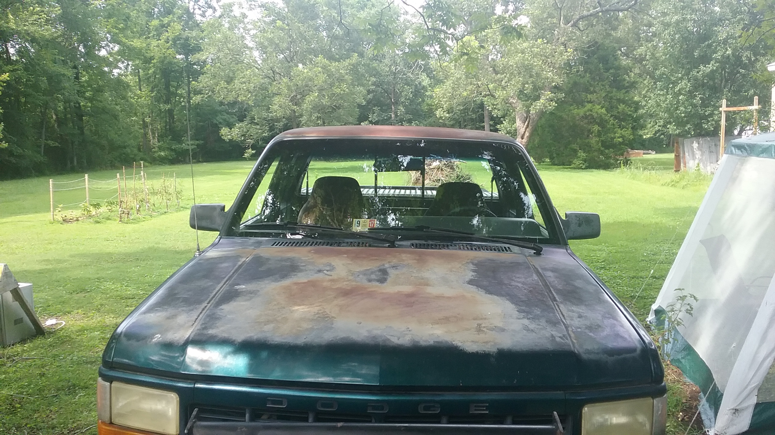

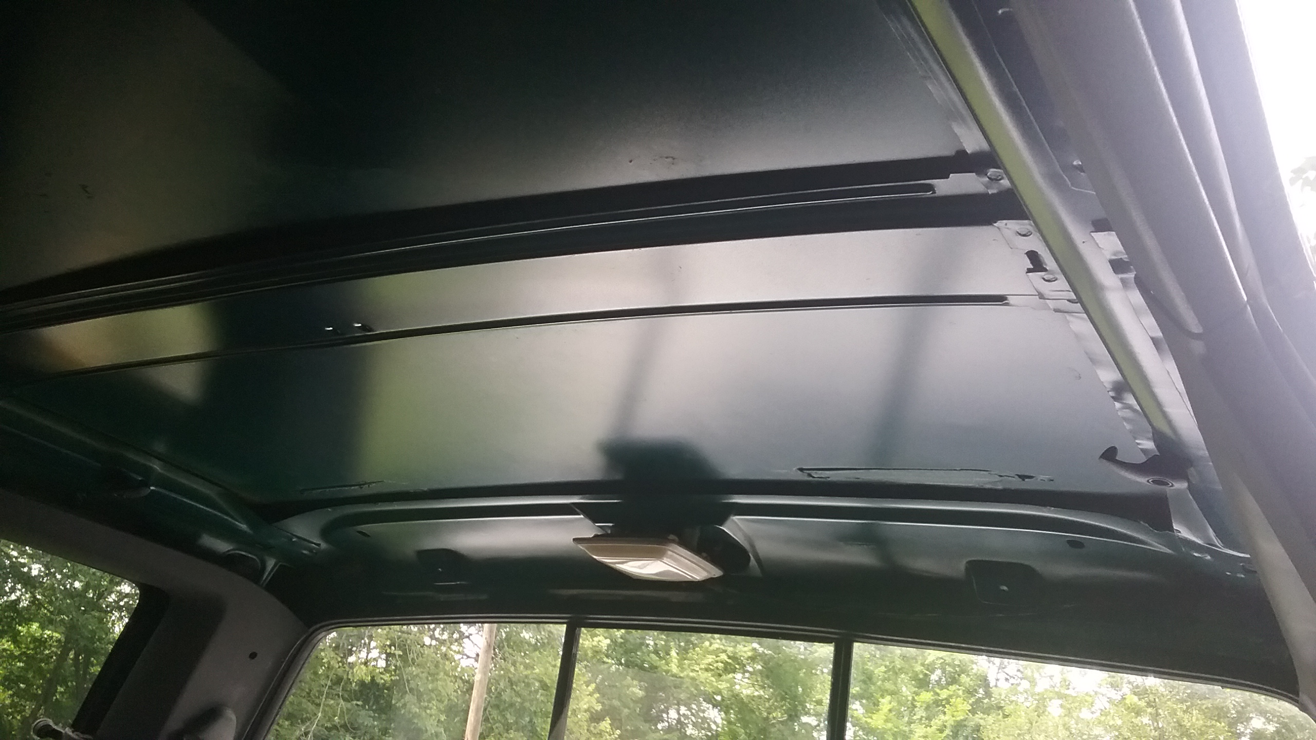

ok yall , got pics here they are
Attached Thumbnails over drive wont hold?-20170725_152907.jpg   over drive wont hold?-20170725_152916.jpg   over drive wont hold?-20170725_152925.jpg   over drive wont hold?-20170725_152939.jpg   over drive wont hold?-20170725_153101.jpg
