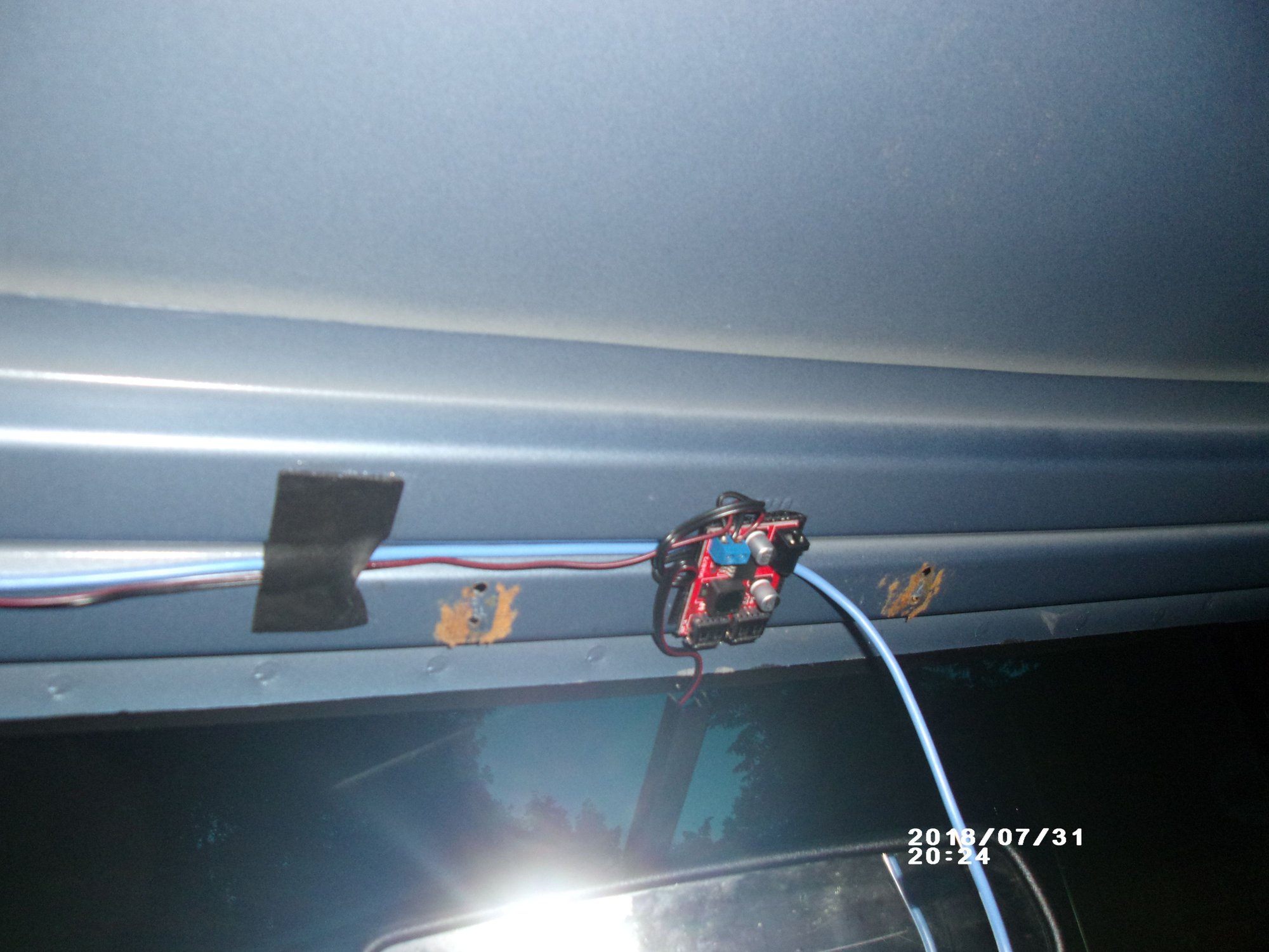

I forgot to post these yesterday.
Three pics from part of what I did.
Dual USB Charger, audio extension cable for SatNav, and auto dim mirror with compass mounted
Closeup of the dual USB mounted.
Wiring run down the "A" pillar on driver's side.
RwP
