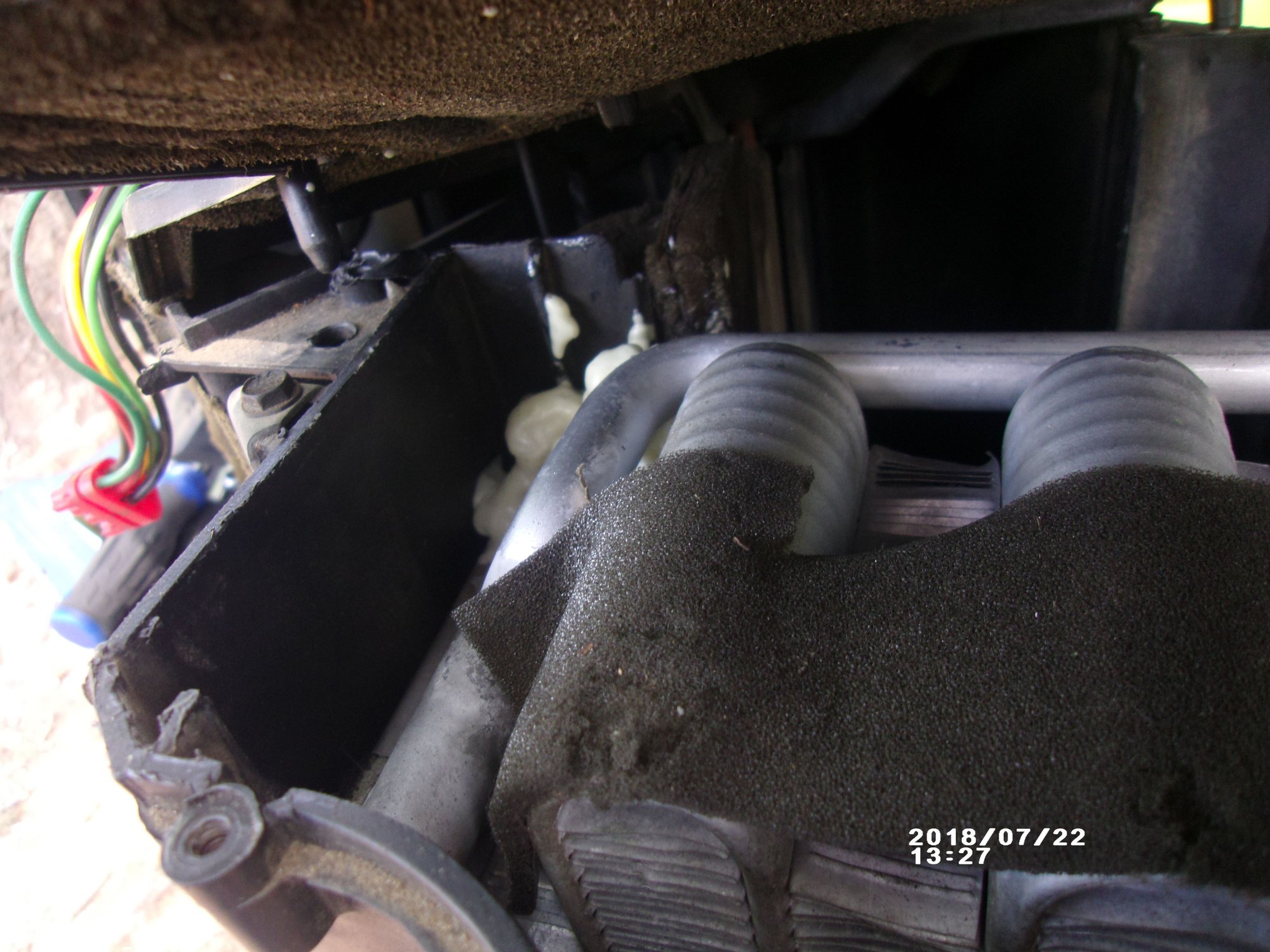

Got the HVAC box out. Note: The long sides are NOT top and bottom, but lower-right and upper-left (to the truck; lower-right and upper-left if you're looking over the motor) for the four bolts for the HVAC box. There's one by the condensate drain, one right above, one about 6" to the passenger side about 1/2 up and down between those two, and one over below the heater core tubes on the driver's side.
That one by the passenger side took a bit to find; the driver's side almost lines up with the top one over the condensate drive.
EDIT: Didn't think to take pictures going apart, but I'll take pictures going together.

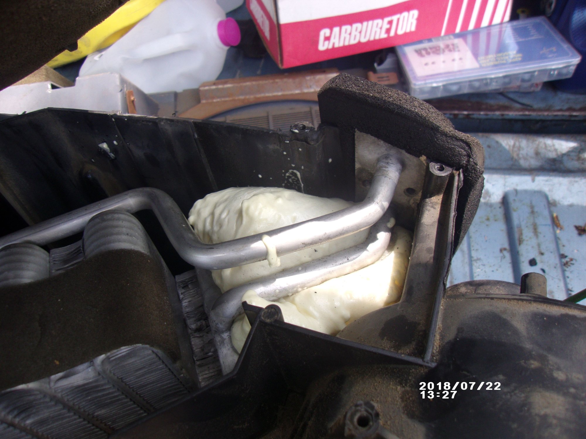

Edit 2: Just as a FYI ... if you use Great Stuff or some other expanding foam to fixate the evaporator (or heater!) core, tape it in place first (using tape out of the air stream, natch!) THEN after shooting the foam in, put the lid on so that you can, well, put the lid on. Took an extra 30 minutes of trimming of the foam where it bowed the firewall side out a bit when it expanded ... *facepalms at self*

A few pics attached.
Foam In Place to hold evaporator
More of the foam in place; trimmed to not hit the blend door.

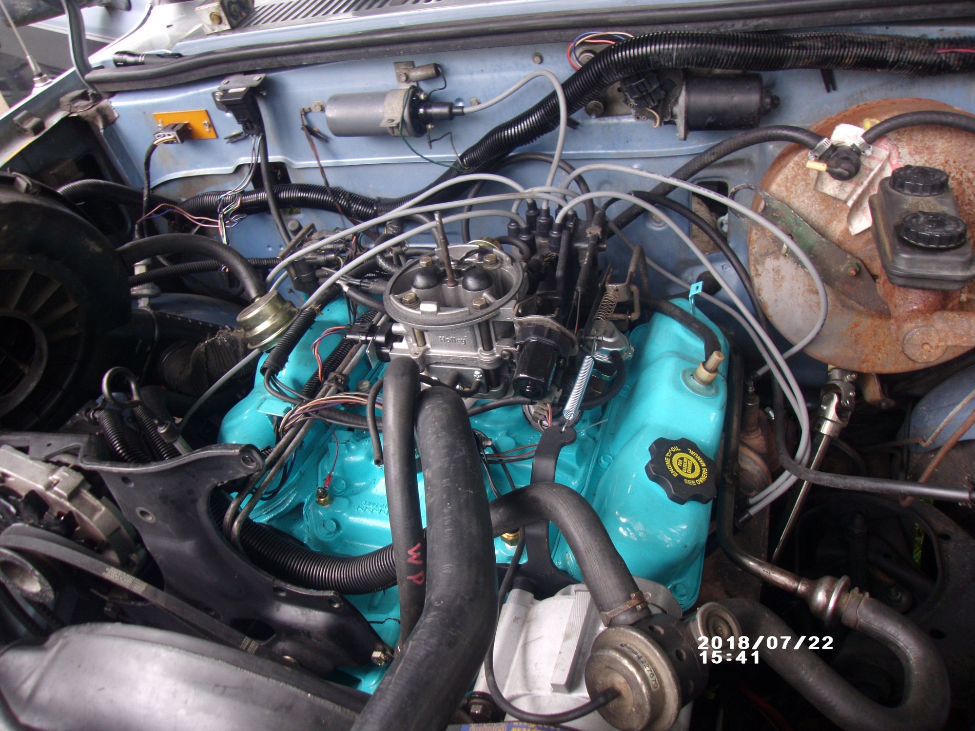

Replacement Vacuum lines in place - notice the Adel clamps to hold them without abrading.
Ain't she purdy!

Very purdy. Isn't that the old Pontiac green?

Might be; the spray can says "Seafoam", and it's Rustoleum
Doesn't matter to me.
Another friend said, "How'd you get old Chrysler Corporate Blue? I thought that was discontinued!!" So, make of that what you will.

Looks good Ralph! Question is... When you gonna throw some paint at that brake booster and master cylinder? The rusty look is throwing off the Fung shue
Hee!
I just might while the seat is out; it's a perfect excuse to pull the master cylinder off the booster so I can clean it up a bit (and touch up the push rod adjustment for Justin Case, my cousin.)
