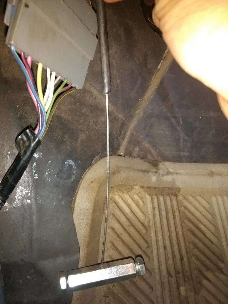

Now because I was a dumbass and cut through the GOOD hood latch cable on my '94, I had to rig something up for the broken hood latch cable on my '93. So I cut the lever off and made this after perusing the hardware store. It works.

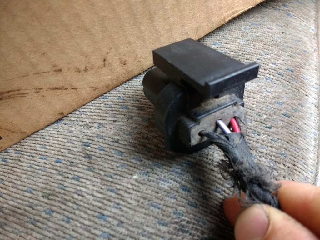

The headlight plugs are different. The headlight housings themselves are the same. This is the '94:

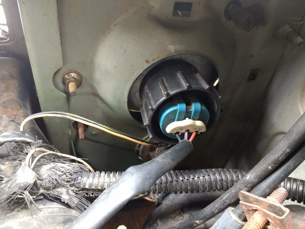

This is the '93.

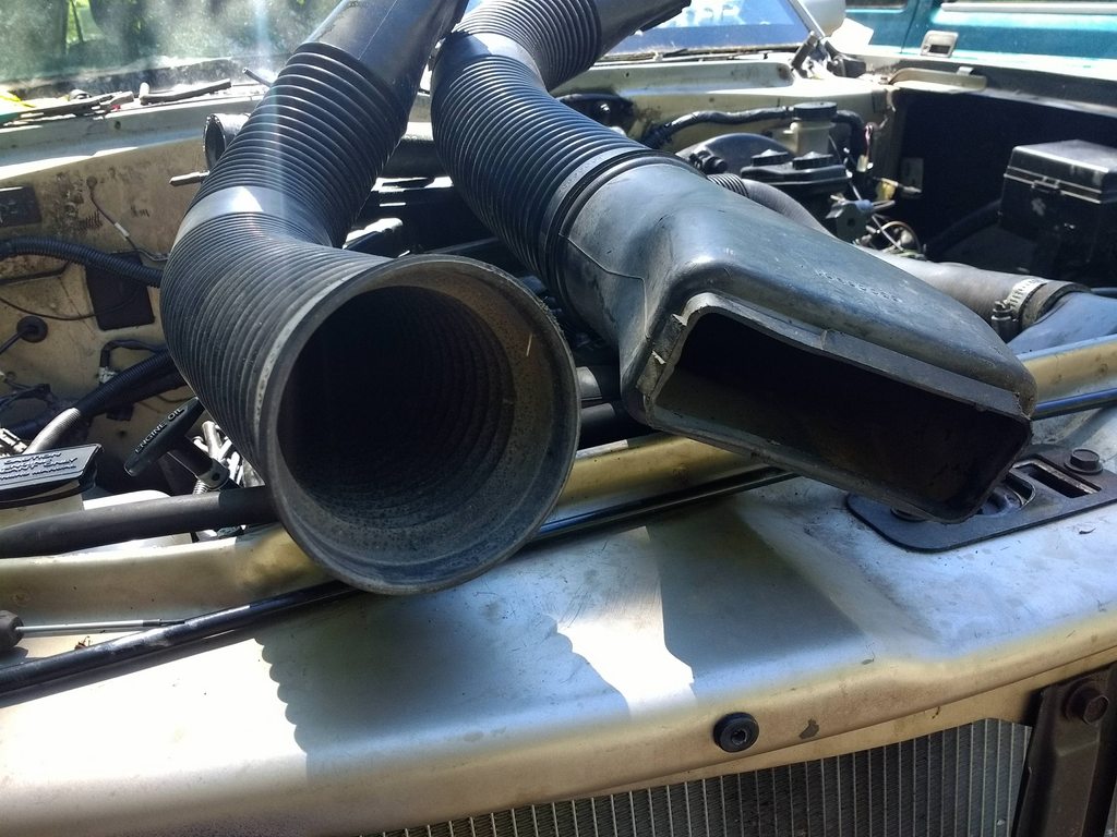

The intake entrances are different between the '94 V8 (left) and the '93 V6 (right). Thus the snap-in intake tube connectors at the rad support are different.

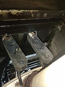

I had to get the exhaust down lower because it was hitting against the bottom of the cab. So I bought these longer/adjustable exhaust hangers. Worked awesome.
This is the '93.
