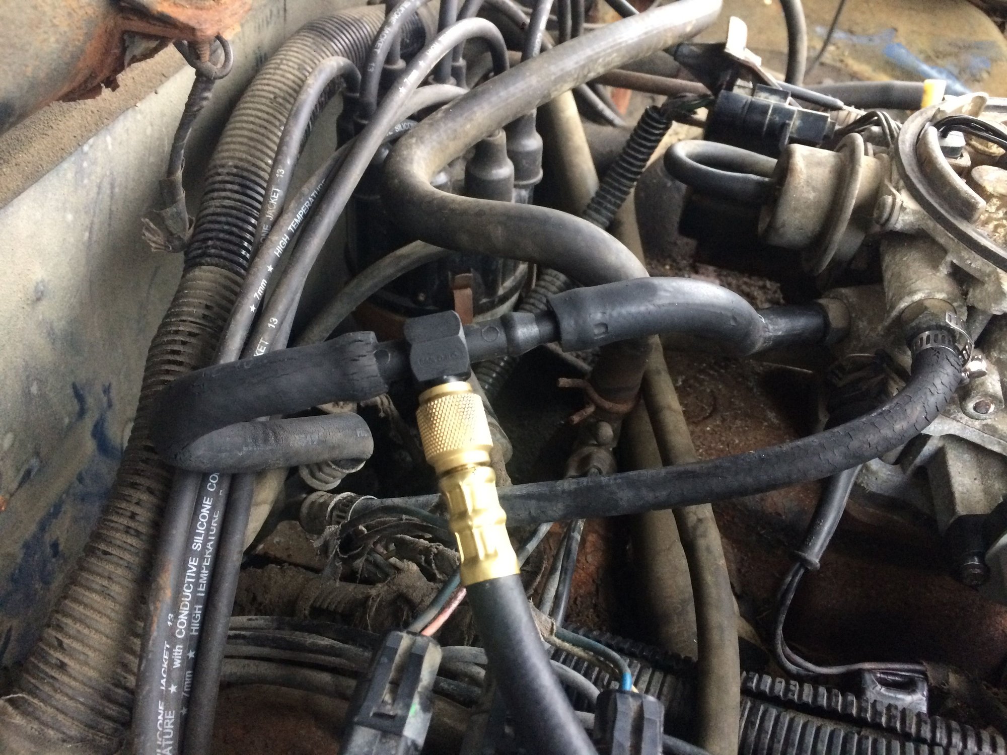

Default Fuel pressure test
I bought a fuel pressure kit to test on my dakota
since it doesnt have a fuel rail, i put one side of the tester iinto the fuel hose and one into the fuel hose connector (into the carb) both were linked to the tester.
i remove the fuel gas tank cap to depressurize the system. Result: the pressure went to like 2-5 psi.
there was a lot of gaz flowing but is the pressure not enough high? And could it make my engine stall like that?
Thanks,
jordan

While pump is pumping (hint: may need to bypass the ASD relay for this), you should get 14.5psi for the TBI motors.
If you're not getting that, AND you're not in the return line, you've got a bad pump.

Default Picture
this is how i plugged it, started the pick up and like 2-5 psi only..
