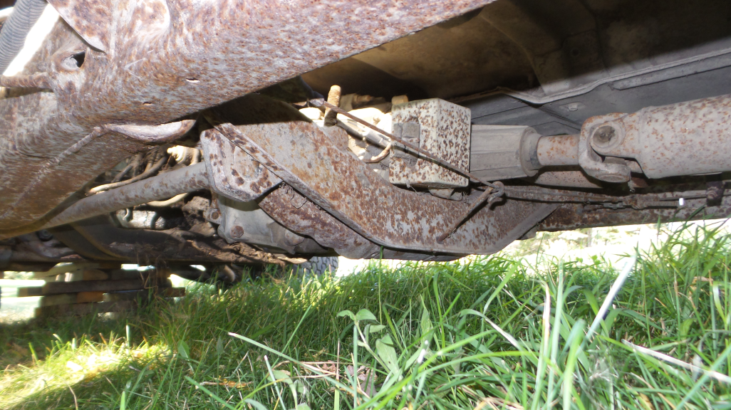

Yes it looks like mount shares the same location, the 4x4 cross member is a bit different and is bolted to the side of the frame unlike the 2 wheel drive member bolted from the underside.
The deal breaker here is going to be the cross member that supports the back end of the transfer case and also is part of the torsion suspension. His 2 wheel drive transmission is going to be a whole lot shorter with out the transfer case and I do not think a one piece drive shaft is going to work.
That crossmember is welded to the frame.
The truck that I'm getting these photos from is a 95 4x4 with the extended cab, long box, same as my 96 2 wheel drive which has a longer wheelbase and uses a two piece drive shaft.
