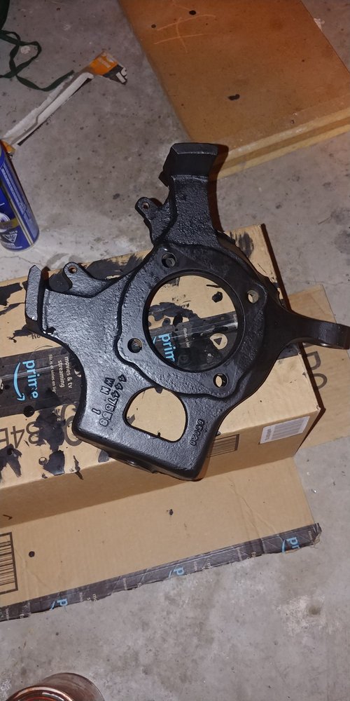

Look what I found! Well technically my wife found it but the details don't matter at least it turned up!
Got my diff carrier back together Now just need to setup the rear end and it can finally go back together.
