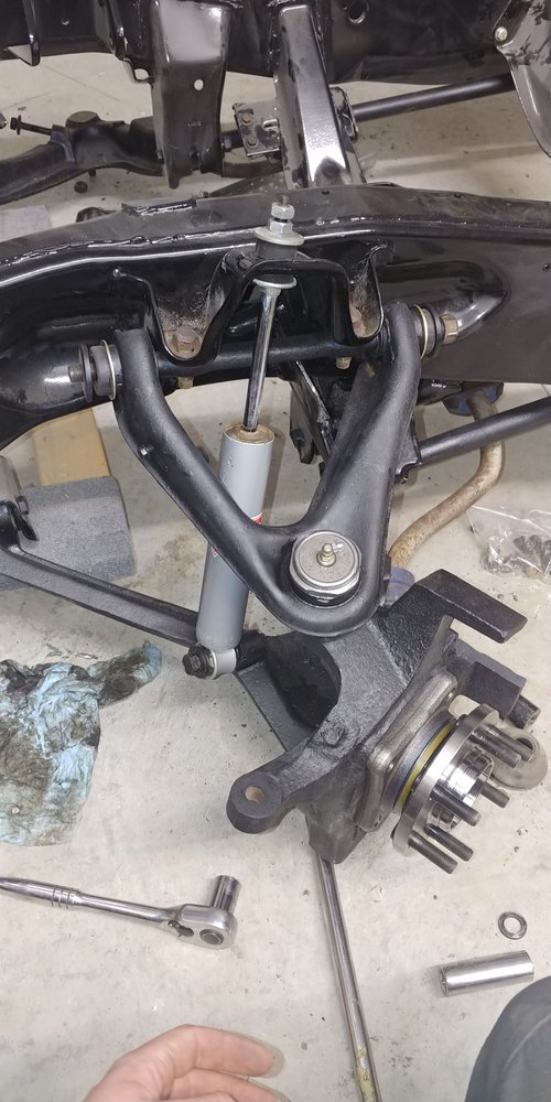

Been slowly assembling parts. Lower control arms are on. Can't for the life of me find one of my steering knuckles though. It must be around somewhere ill have to keep looking.
Finally got around to taking apart my rear diff carrier. Surprisingly the cones have not bottomed out yet. It must have been replaced at some point, I find it hard to believe after over 400,000km that it is still in good shape. Will have to clean it up and throw it back in.
Just got my roll of copper/Nickle brake line so will start forming brake lines soon. Turns out I broke the lens on my phone camera so no new pictures of the truck for now.

Havent updated in a while. Had a bit of a pause while the weather turned nice and we could finish up combining. Starting to get front suspension together, but still can't find my other steering knuckle. Oh well I guess that's the benefit of having a parts truck.
Engines down to a short block now. Talked to a local machine shop, they'll clean up the block and measure it up for me for a pretty reasonable price. Not worth my time for what they want so once torn down I'll be sending it out.
