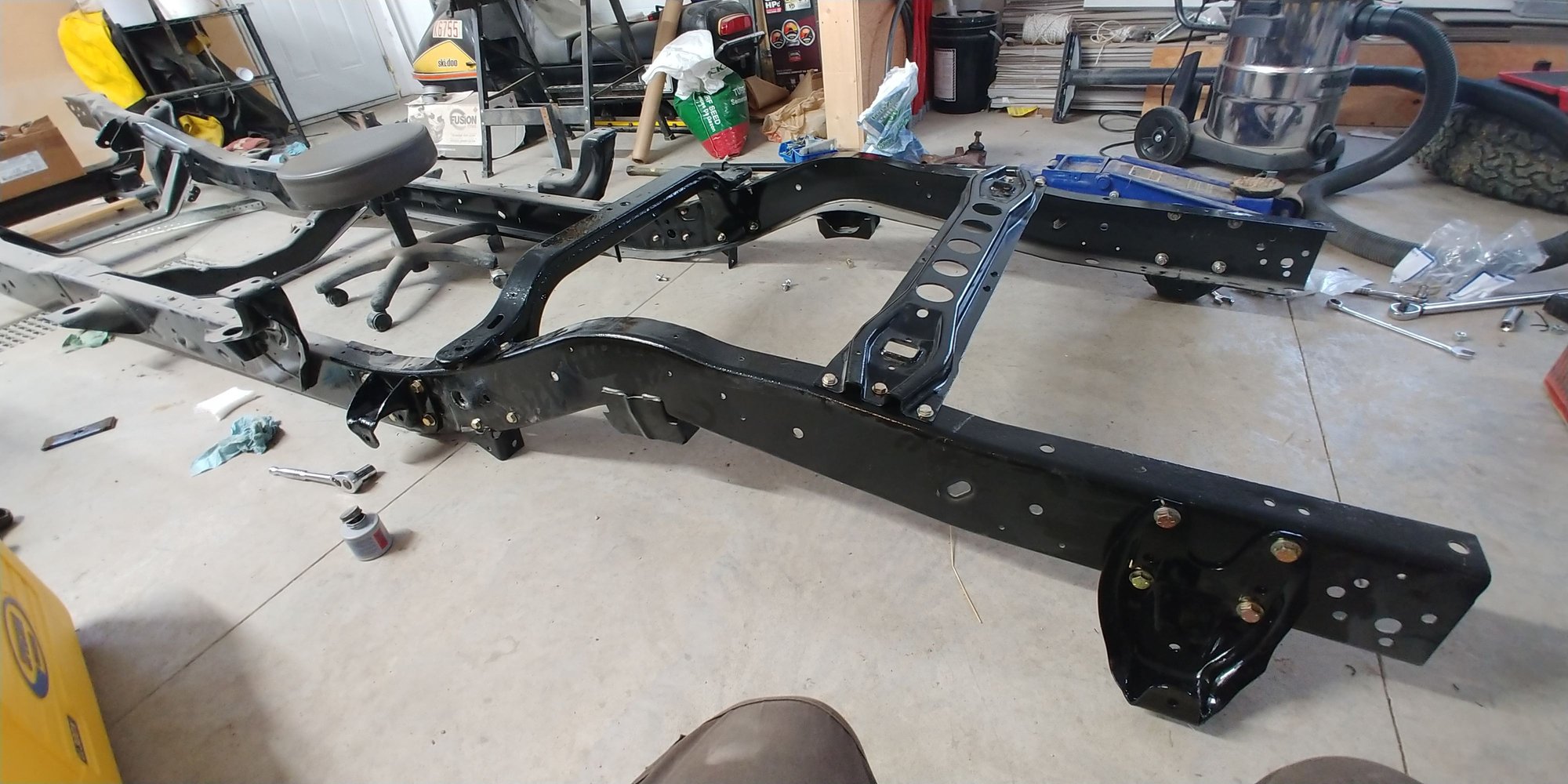

Well since the diff is on hold for now I've finally started actually bolting parts onto the frame. Guess I'll have to finish rebuilding the rear end under the truck, not a big deal at least it'll be clean.

Got the rear suspension and axle loosely mounted. Makes me wish I would have painted the leaf springs, but gotta draw a line somewhere, it's not a show truck after all. Removed the ball joints from the lower control arms and got the bushings removed from one of the uppers. Get the other ones removed tomorrow and start putting the front together.
Gave a quick coat of paint on the abs valve and the proportioning valve, will have to take them to the parts store this week to get the fittings matched up to make new brake lines, unless anyone knows what sizes everything takes off hand. I know the wheel cylinder is a m10x1.0 but not sure after that.
