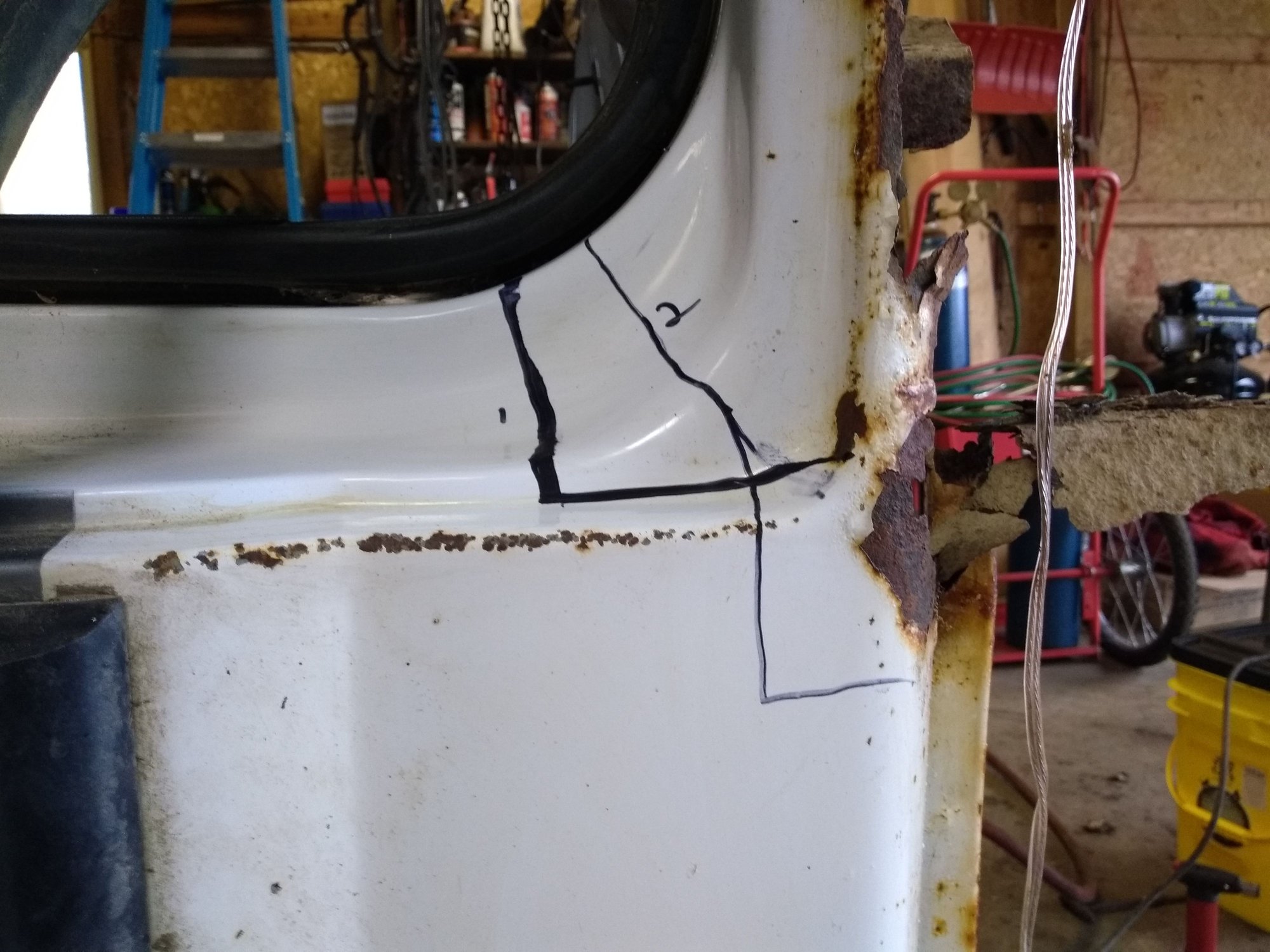

So I got all the frame mounts rebuilt and reinforced on Sunday. Now the frame is ready for me to be stripped down and painted. I've gotta pull the engine/trans and transfer case, remove all the brake lines and fuel lines, front suspension. Then I get to get all the rust off and por15 the crap out of it.
i also started cutting out the floor pan
Here's some pics

Wow, that's some significant repair work going on there. Think it's great but man you must really love that truck!
Nice job

Yep I definitely love this truck. Best part is I'll be one of the few people that have turned literally every nut and bolt on there vehicle and I'll have the piece of mind knowing I did it right. It'll be better than what Dodge could ever do
