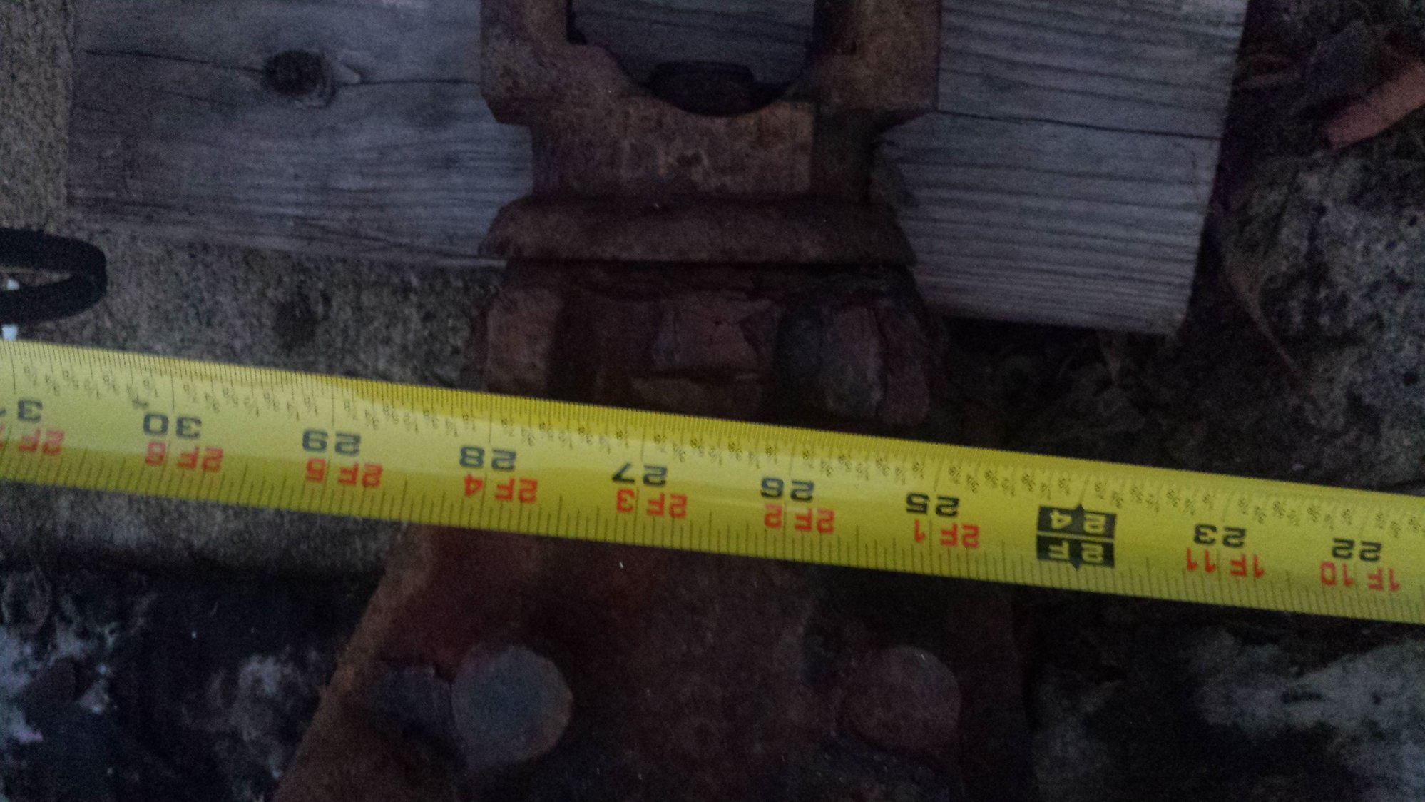

Let me re-word it. The measurement from the backing plate to the center of the yoke is not equal....... Below, I took pictures of the old 8.25 sitting in my driveway....
In short, the difference is about the same or close with the 8.8 I used.
FWIW All I did to set mine up was, I used a tape measure to equalize the centering of the axle. I measured from the fame to the brake backing plates and shifted until it was equal.
I then used a digital level and set the pinion angle as the same as the old 8.25.
I then welded the 2 spring perch to the axle.
Thats all I did to set mine up. and again, FWIW it is smoother then the 8.25

Well, the center of the yoke isn't where the shafts end; one shaft pokes past, the other one is a good inch or more away.
Look at the design of an open diff (where it's easier to see!) and see what I mean.
Yes, the yoke's off center, so that both axles can be the same length. If the yoke was centered, the shafts would be DIFFERENT lengths
RwP
