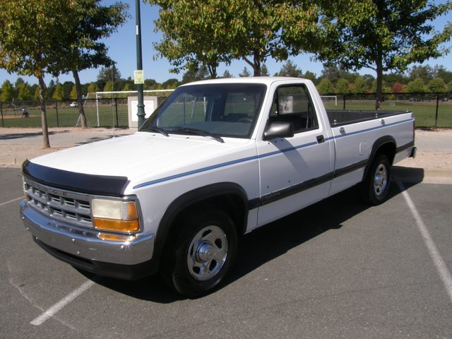

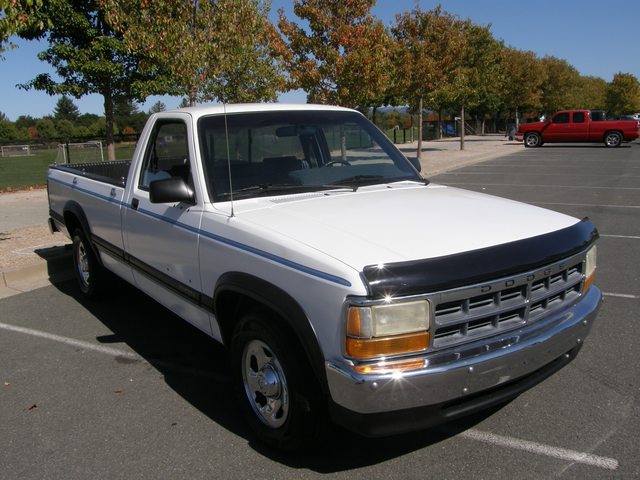

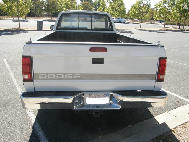

Painted my '95 dakota.......in my garage!
I've owned this truck for over 20 years. My dad bought it new in '95 and when he passed in '98, it fell to me. Best darn truck I've ever owned! However, about 5 years ago the paint started peeling off in sheets. Cheap Mopar paint that the factory used in the mid '90s. I've seen lots of other Dodge trucks from that era with the same problem. I rebuilt the 3.9 at the 150k mark so mechanically, it's sound. I decided it was time to spruce it up a bit.

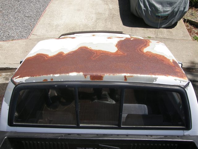

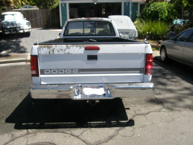

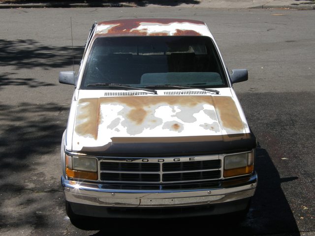

Quite a bit of rust had formed on the roof and most of the paint had peeled off the hood. Paint was peeling on the tops of the fenders and tailgate also.

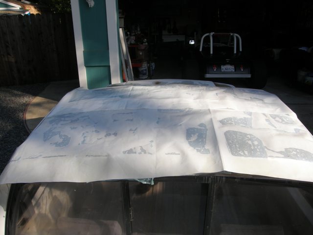

I thought I'd try Evaporust on the rusty roof. Followed their instructions to the letter. I soaked some super absorbent paper towels with Evaporust, layed them on the rusted panels, covered with a tarp and waited 24 hours. Came out the next day and not one particle of rust had been removed! So much for that garbage!

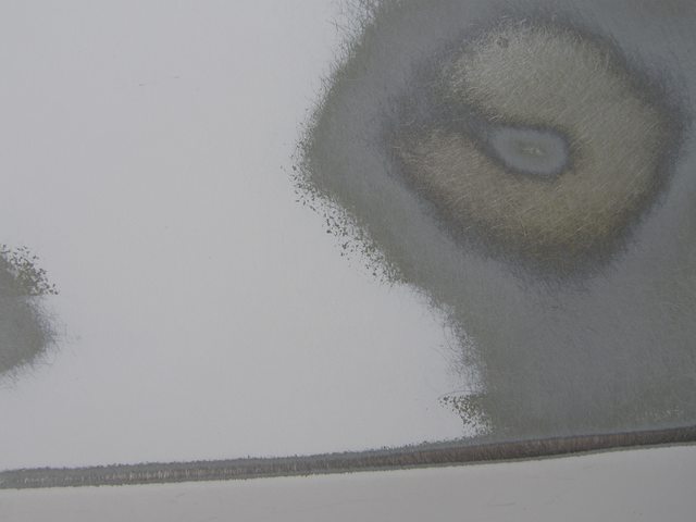

I wound up attacking the rust with some 36 grit and that took care of that. I then stripped all the paint above the mouldings with 80 grit followed by 150. I left the paint below the mouldings alone 'cause it was in good shape. I used 320 on that so the new paint would stick.
The white paint would not feather edge so it all had to come off.

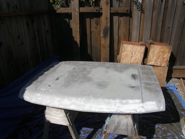

I removed the hood, cowl panel and tailgate and sand blasted them in the backyard. It was just easier that way.

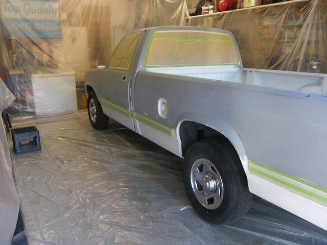

Layed on a few coats of 2k primer.

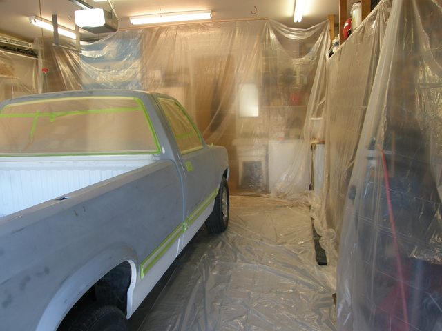

I sanded the primer with 150 and masked the truck. Home Depot sells 200 sq ft of 1mm thick plastic sheeting for $3. $15 later I had my paint booth.

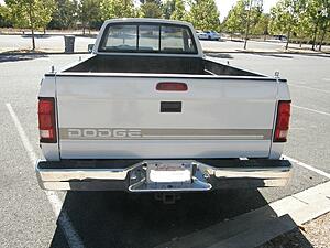

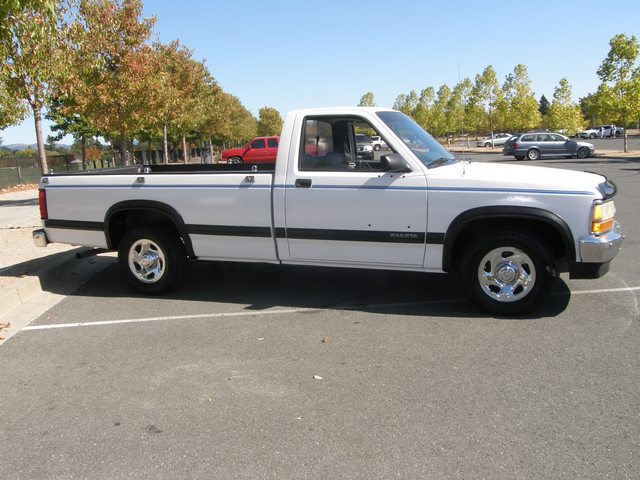

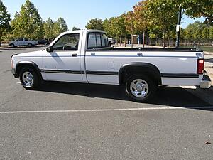

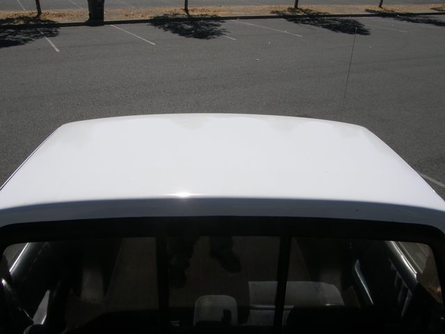

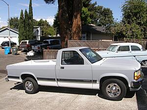

I shot 3 coats of color followed by 3 coats of clear. I used SEM Trim Black on the fender flares, air dam and mirrors. The original blue stripe is a decal and it's made of unobtainium. Not available anywhere. So, I got a few ounces of blue and silver toner and painted the stripe on then cleared over it. I'm a rookie at this so there's a couple runs in the clear. Ideally, I should cut and buff the whole truck but, it's a truck. I use it for hauling and going to the dumps. I just wanted to get some color on it so it looks half way decent. In addition, there's a couple of small dings that I didn't fix. But once again, it's a truck! I'm good with it. The wife thinks it looks like a new truck. I kinda have to agree.
