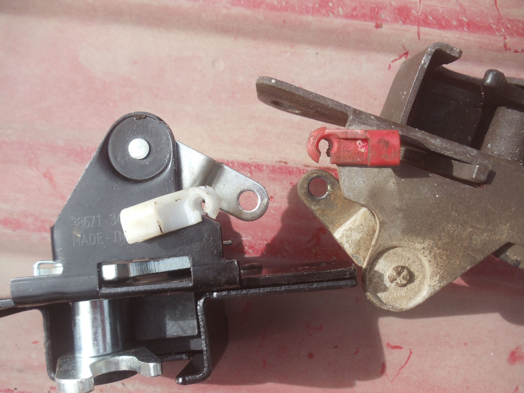

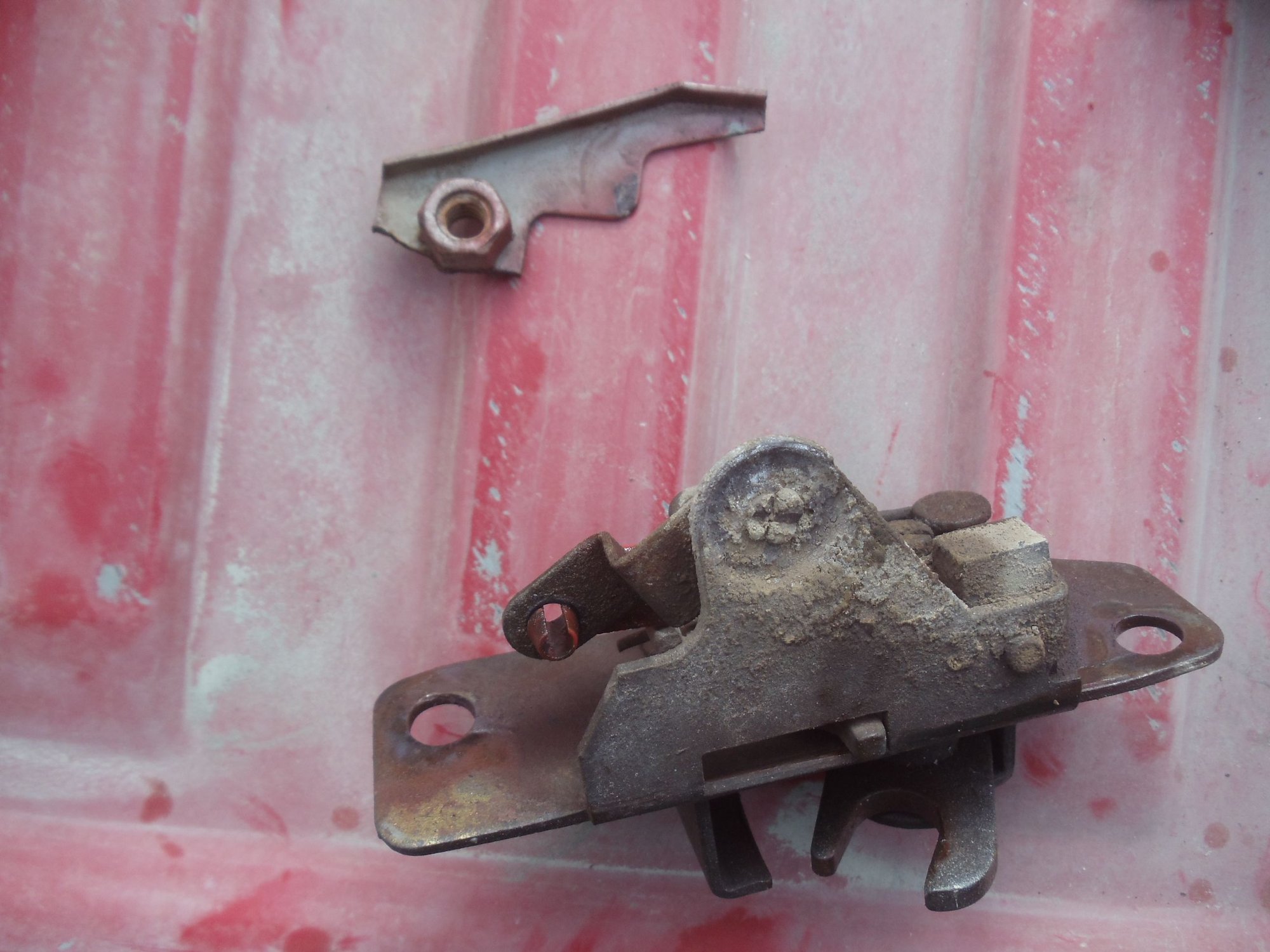

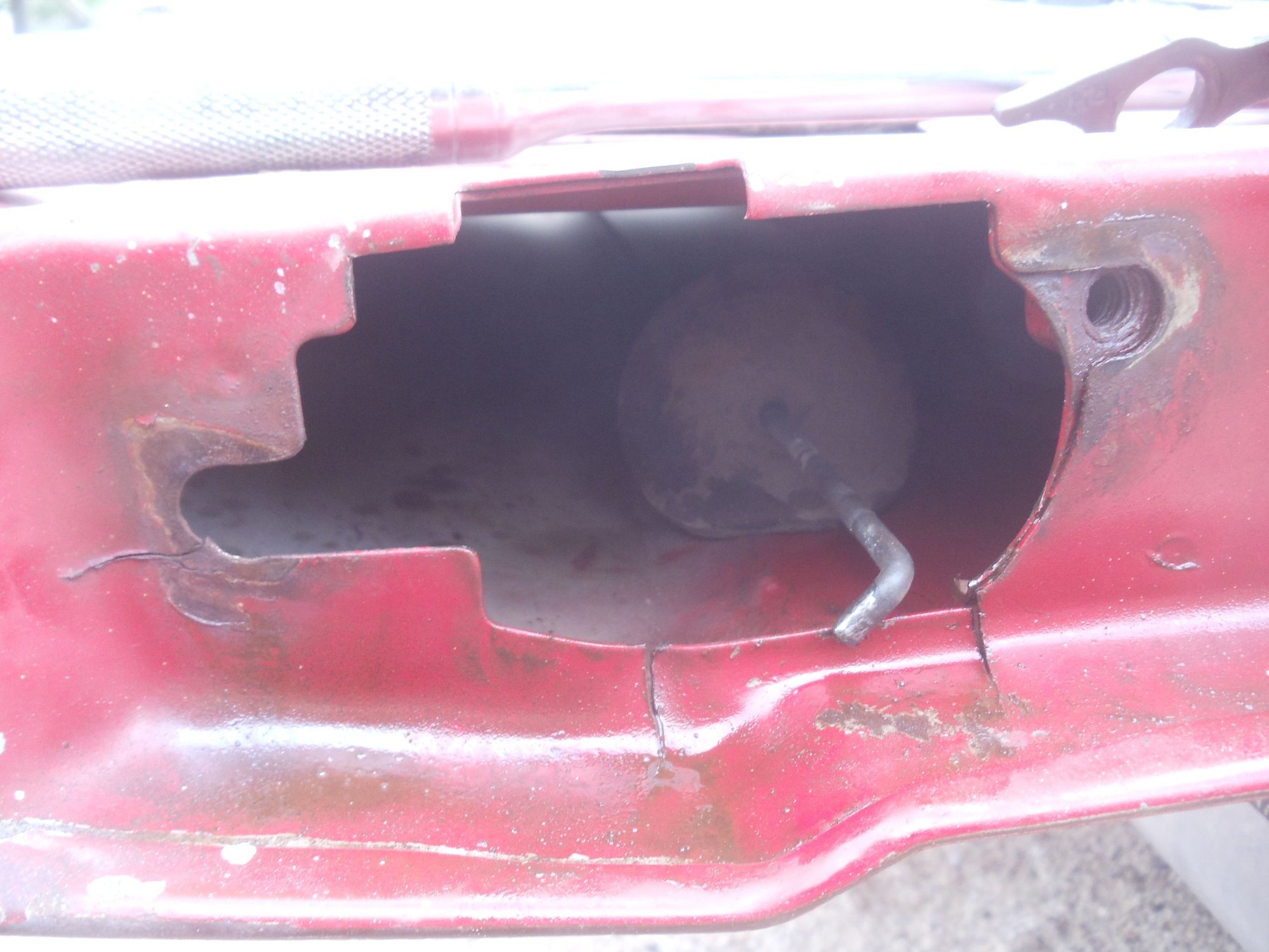

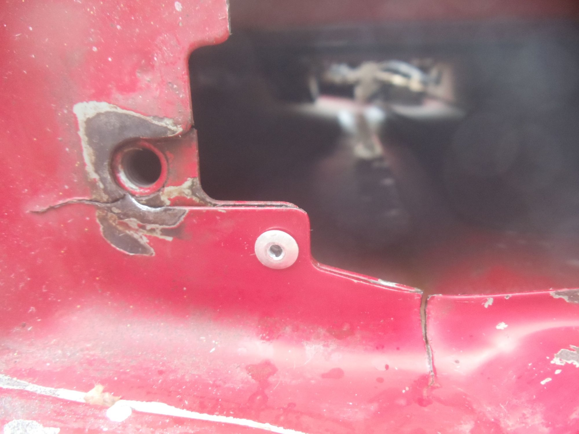

Photo one: The hole in the white Dorman plastic clips for the release rods are too small in diameter so I reused the red factory clips. The factory latch is constructed from a single stamping and the Dorman latches are two stampings stuck together. Photos two and three: I found the main problem for the passenger side rattle was because one nut that is welded to sheet metal had broken free. Photo four: I don't weld, so I reattached it with one 5/16" rivet. I reused the four factory fasteners because they have a chamfer on the tips which helps to prevent cross-threading. I tightened both striker pins 90 degrees clockwise so the worn areas were no longer making contact when closed. Tailgate is now good and tight, but i need to remember to close it with less force from now on.
