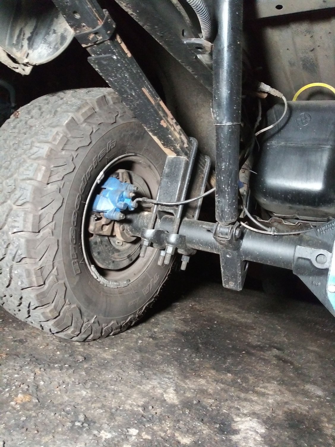

Something is not right...... You said it was a solid rotor, and your picture is vented...... Explorer has a solid rotor.
That caliper does not look like a explorer. Enclosed is a picture of a 8.8 out of a explorer in my truck.... The second picture shows the explorer rotor is solid.. The third picture is the best I have of the caliper on the inside.

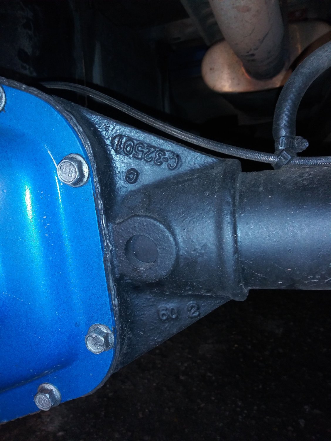

Are you sure that is a dana 60? If you could show a picture of the diff. cover it would help....... so we could see the bolt pattern.
Any chance what you have is a 9.25 out of a 03 or so dakota or durango? It looks more like that too me. But the pictures you supply are hard to tell much from.

Well from those pictures, it does (to me) appear you have explorer calipers..... If you are running a 6X4.5 pattern, I would suggest that you do as "hey you" said, contact the company that did the conversion, or talk to a machine shop about drilling the stock explorer rotors to the 6X4.5 bolt pattern. Assuming it is a explorer......
FWIW, I still would have liked to have seen a picture of the actual rotor, from the wheel side, or at least a picture of the outside of the wheel.
Ill be honest, what has confused me is .
1. In your opening post you said. "I have 92 4x4 5.2l with 6x4.5 lugs. Dana 60 rear Dynatrac axles that have ford explorer pads and calipers. Which leads to solid .5in rotor 1.5in hat disc/e brake"
2. Then in post 7 you show this picture, which is not a solid rotor......
3. Then in post 14, you show this picture.
Now these are not the same rotors.......
This is part of where I am confused....
Again, it would be nice to see a picture of the outside of the wheel, and a picture of the truck jacked up with the wheel off, showing the outside of the rotor...

twas Dynatrac axles. Got worse last night. My buddy says even though differential housing says 60 2 bottom right of dif. He says my cover is Dana 70.

That's a dana super 60, with 35 spline axles. At least, according to the cover..... Should be numbers stamped into the axle tube, that you can decode on Dana's site.
Dynatrak should be able to tell you what rotors you need.... After all, they are the ones that built the axle.

I want to ask you something, and I dont mean to put you down or sound mean saying it, But you have come on this forum asking for help with a rotor, and yet you have posted several pictures, none are of the rotor on the truck, at least the face of it......
Can you pull the wheel and post a picture of the rotor? If not, just say so........ It makes a difference in what help or suggestions we can make.

1. Your friend is wrong on the cover being dana 70. FWIW dana 60 and 70 use the same cover.....

apologies yes. First pick is the vented front6x4.5 non Frankie. The back is the solid Frankie drill holeio
