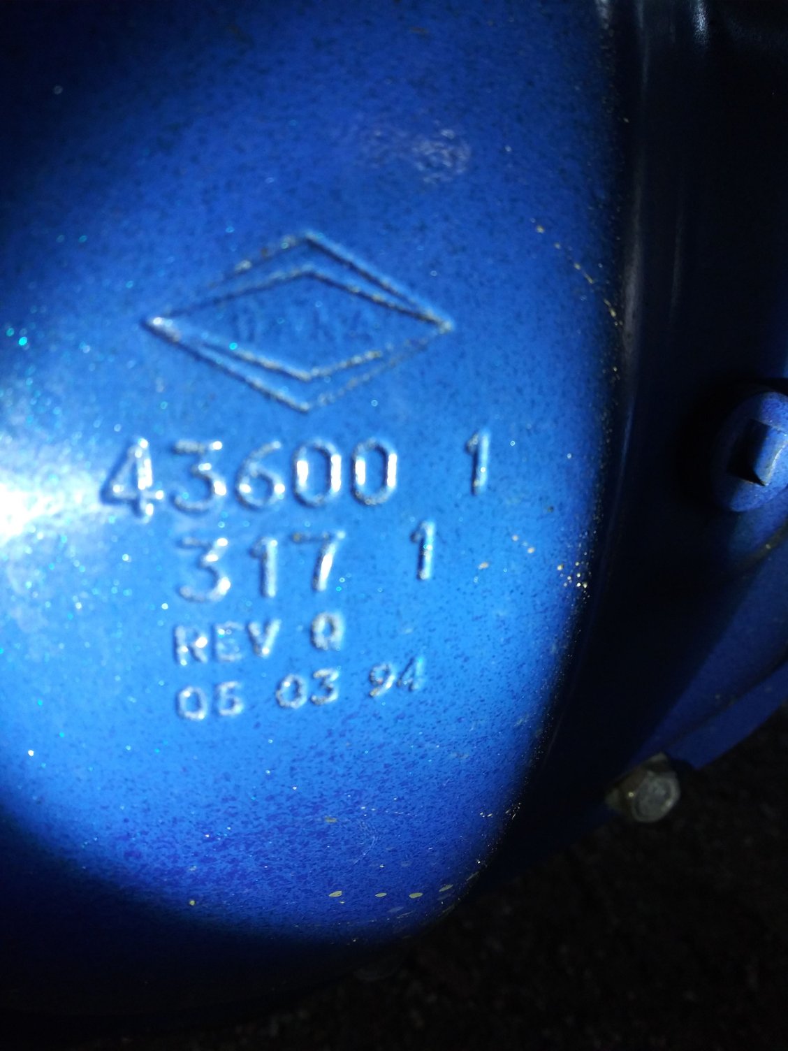

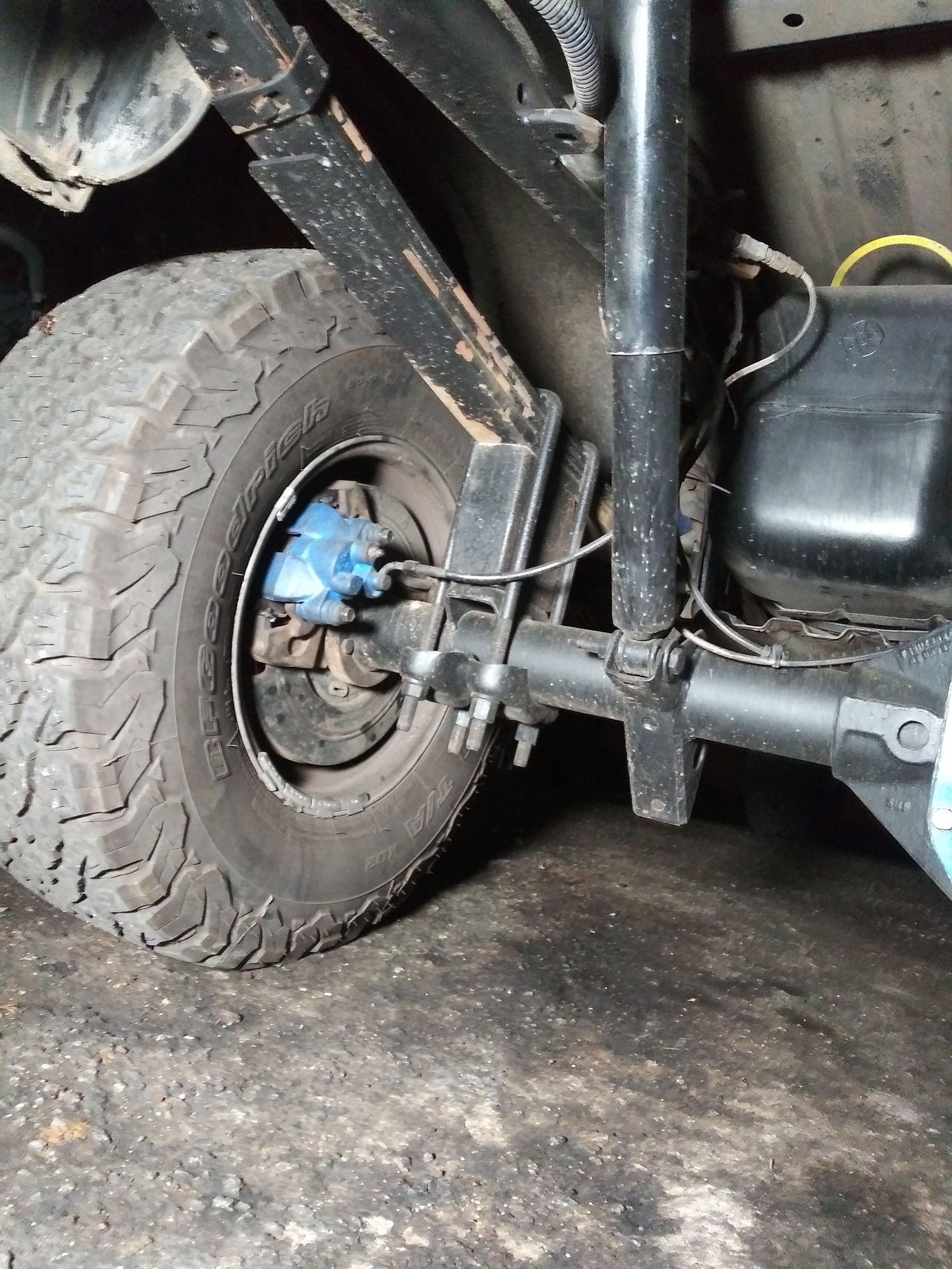

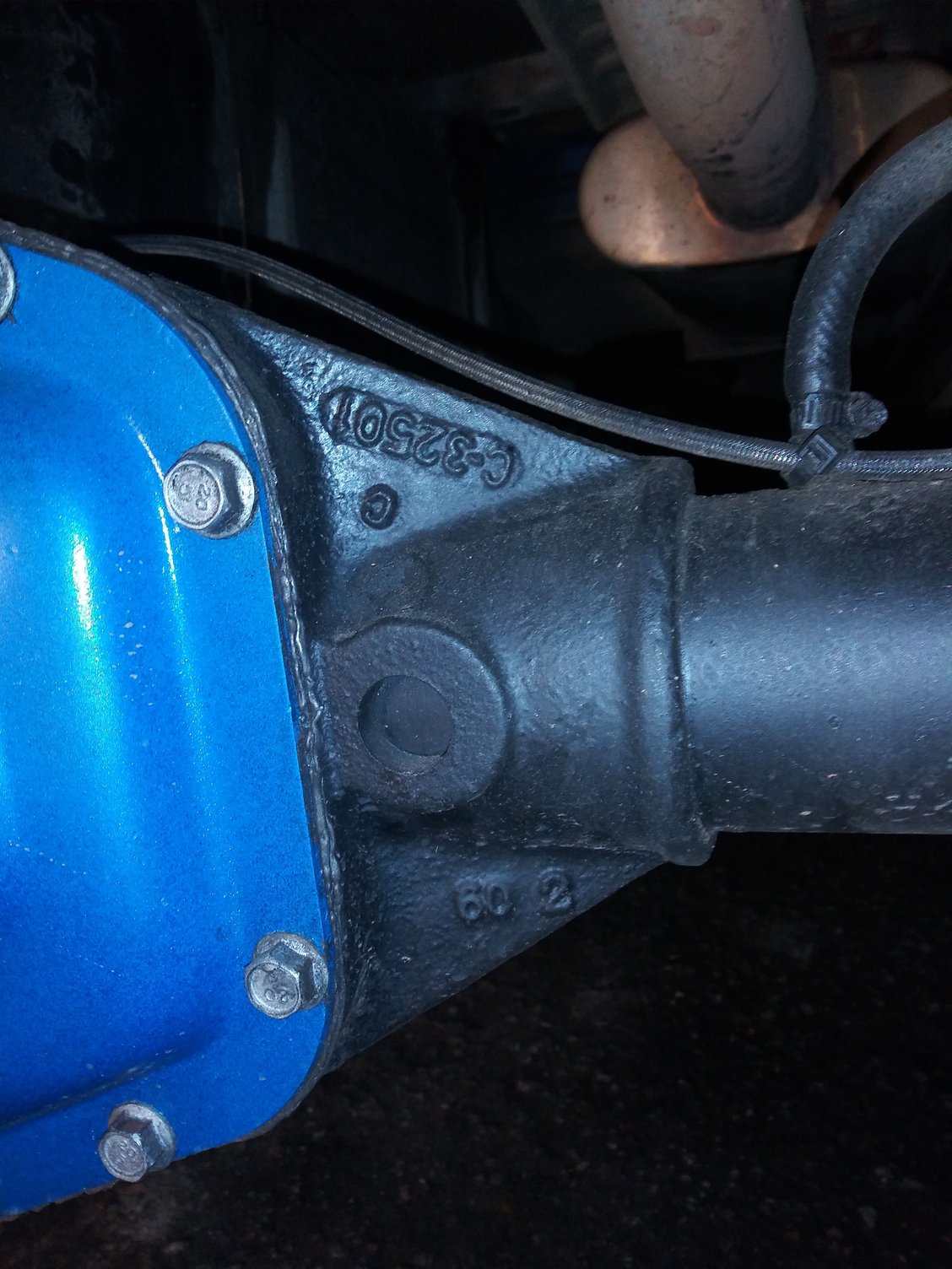

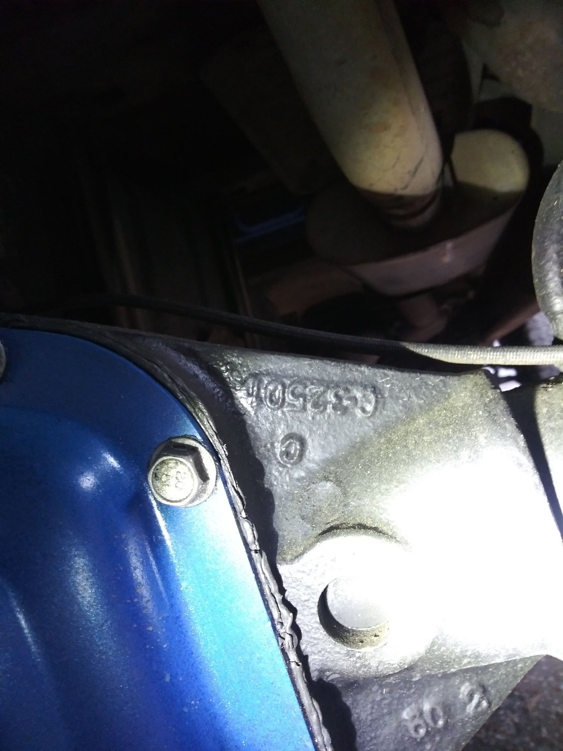

Originally Posted by 93 ragtop
Something is not right...... You said it was a solid rotor, and your picture is vented...... Explorer has a solid rotor.
That caliper does not look like a explorer. Enclosed is a picture of a 8.8 out of a explorer in my truck.... The second picture shows the explorer rotor is solid.. The third picture is the best I have of the caliper on the inside.
Are you sure that is a dana 60? If you could show a picture of the diff. cover it would help....... so we could see the bolt pattern.
Any chance what you have is a 9.25 out of a 03 or so dakota or durango? It looks more like that too me. But the pictures you supply are hard to tell much from.
so nice. Yes please allow me to look properly. I will take Accurate information and upload the photos.
and I've only gotten this knowledge by what I've been told. So thank you
