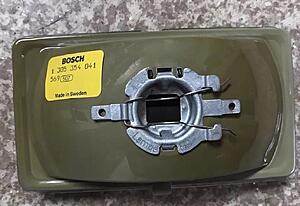

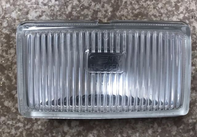

It would have been nice if Dodge would have used a standard off the shelf fog light instead of a special built lamp assembly. There's another thread on here from a while back (maybe a year or so) that talks about these. What I found in my digging around is that the lamp pieces (glass lens / reflector) were made by Bosch but not with the Bosch name on them...with a different name. Those are hard to find now but the comparable Bosch Pilot lamp can be installed in the Dodge fog housing IF you remove something, either on the lens or on the housing somewhere, the other post I mentioned has that info.
At one time I found some parts on Ebay from someone selling NOS lamp stuff. I never pursued it but I did manage to remember to keep the pictures.
IIRC I took a Bosch Pilot insert from another fog lamp that I have and test fitted in the ratty fog lamp housings I have from a Dakota and it fit, and since those seem to be plentiful I would think that's the cheapest way of getting new lights!

Thanks for the information. Nice to know there's many ways to skin a cat. My original lenses had "BOSCH HALOGEN" written on the front in the glass. I found that there are actually there different part numbers that work for this vehicle. In fact they are all the same.
1) 55055140 (Chrysler PN - like you identified above)
2) TYC 19-5339-00
3) CH2592017
I ended up buying one off Amazon.ca and the other I got from Marshall's Auto Wreckers in Lethbridge, Alberta. The one from Marshall's is already installed and working well, the one from Amazon seems to be stuck at a distribution centre. I highly recommend Marshall's if you live in Canada. Friendly people and they still have a few old Dakotas in the boneyard.
