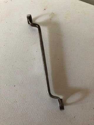

Finished tranny job yesterday. The adjusting screw head on both bands was a square head and I had no socket that would work on the front band so I could not torque it. Had to guess using a 11/32 open end wrench in a tight fit. I was able to use a 9mm socket on the rear band if I tilted the socket. Kinda cheesy and not sure how well it torqued. Sadly, the field service instructions that Ralph kindly provided me did not say they were square heads. They said a 5/16 socket would work on the front and made no indication of the tool needed for the rear band but I assumed they wanted you to use the same 5/16" socket. A 5/16" socket did not work. Anyway, I did the best I could with what I had and the tranny seems to function fine. I also replaced the 3-4 accumulator spring. The piston above was not plastic. Looked like some kind of lightweight cast metal. Not sure. The old spring appeared fine but cannot ascertain fatigue. Replaced 5 liters of fluid. The pan and magnet had very little sludge or metal bits. Very clean. Even the fluid was still nice and pink. It would seem my tranny is in good shape. I've been good over the years to change the fluid and filter. Amazing how durable things are when properly maintained, huh?
So now where to get a socket for square head bolts?? Oh, and that front band is buried pretty good. Luckily I had one of those goofy 3/4" wrenches (see pix) to loosen the locking nut. That did the trick. Was my father's wrench from a zillion years ago that I never used until now. Maybe he bought it to adjust his bands.
Old Jun 21, 2020 | 09:49 AM
  #40
Posts: 87,406
Likes: 4,214
8 Point sockets. You can find them just about everywhere.
