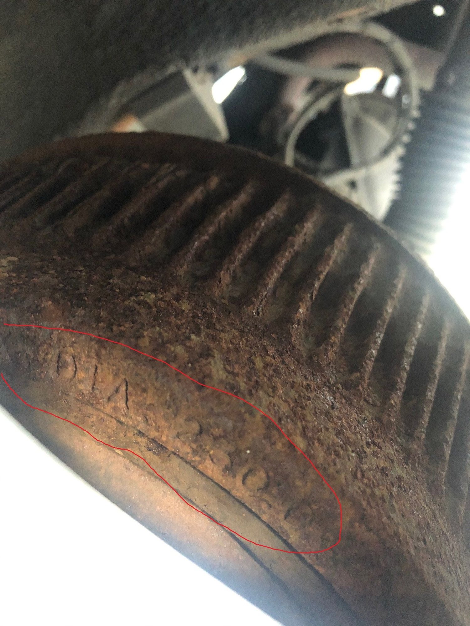

What's weird is the metric units, but I've found metric parts all over the truck. Super weird for a US vehicle.
Max Dia = 230.0
Yep, those are 9" drums.
10" are something like 270mm.
It's not THAT weird; we were into metrification by then, and it's actually just a number to help make the metrification folks happier.
RwP
RwP
Yeah, the whole mixture of standard and metric fasteners used throughout the vehicles of that era is really annoying.
