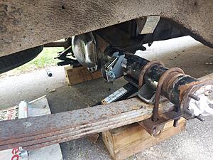

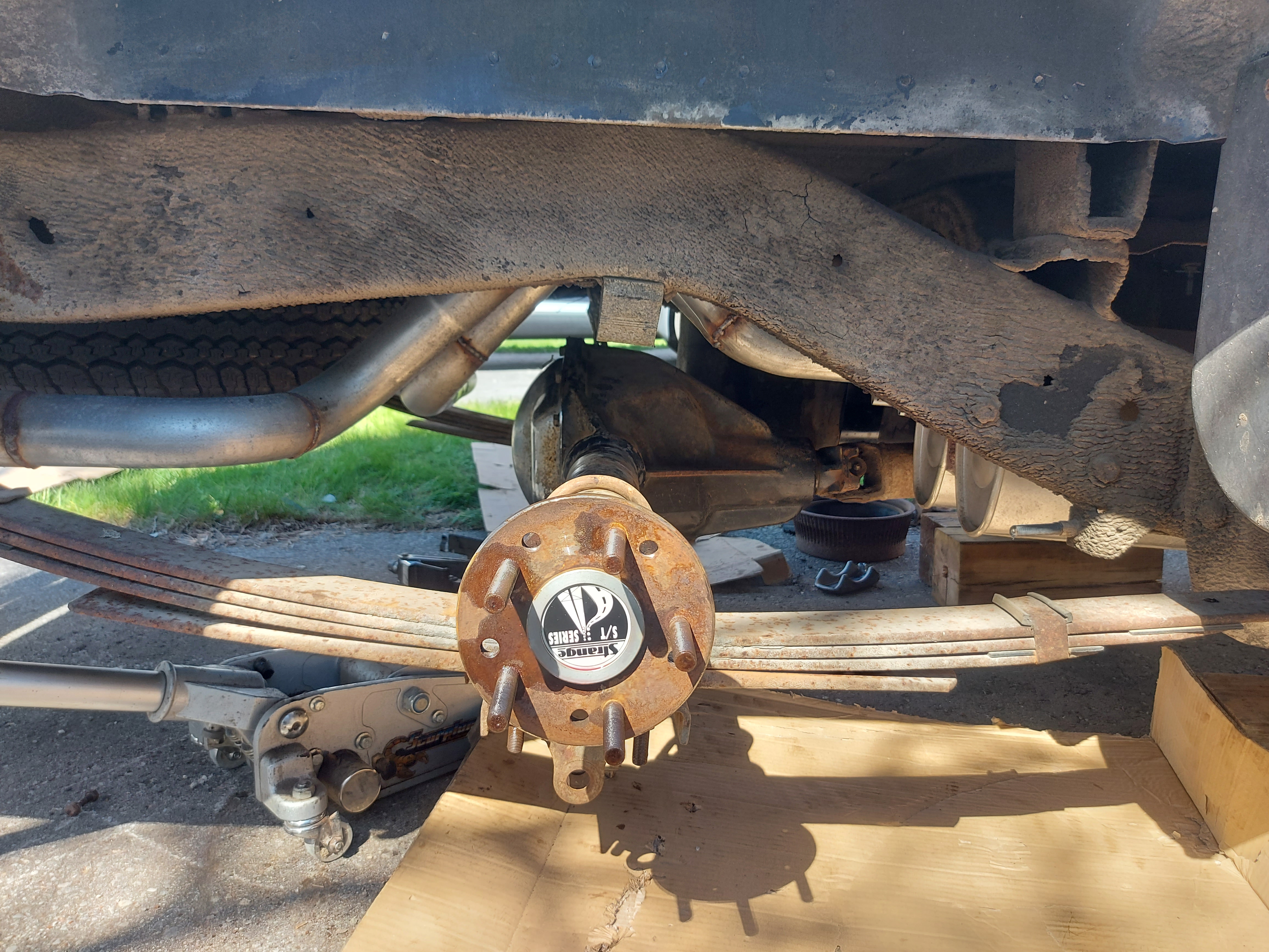

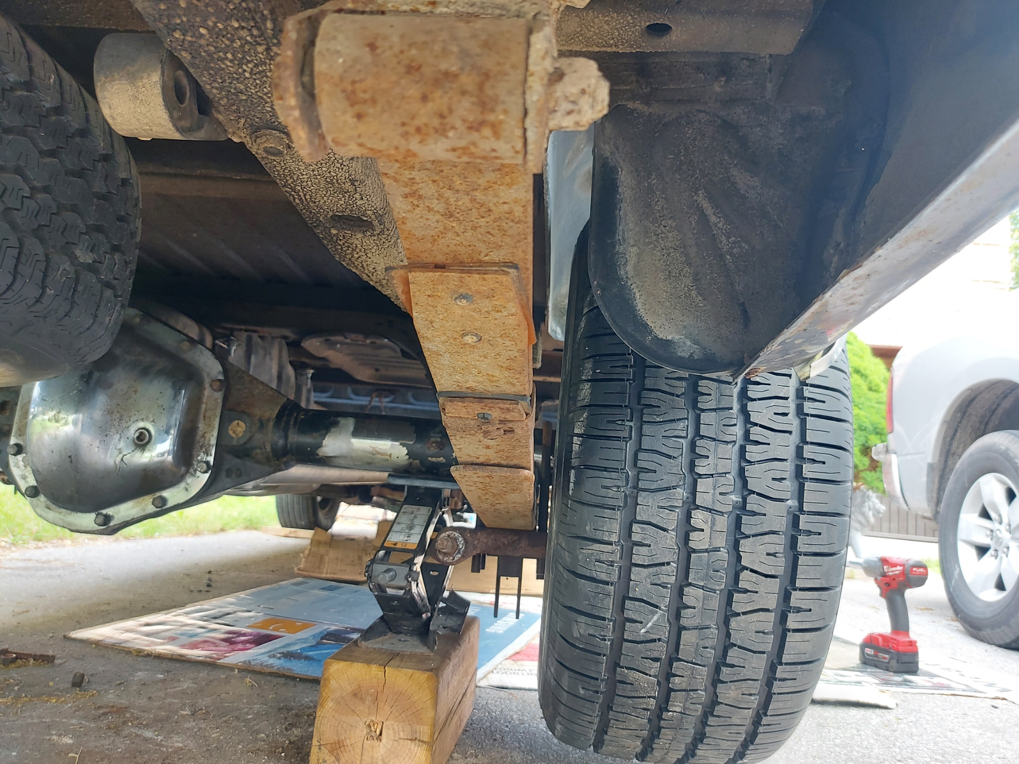

The Dana 60 is a rear end I had narrowed back around 2004 for my 77 Plymouth Volare I raced at the time. Its 3.5 inches narrower than the stock 8 1/4. I just welded the perch mounts and shock brackets and about to assemble the brakes. It has 4.10 gear and a power loc sure grip. 35 spline strange axles.
The 46rh is a tight fit. the transmission mount only needed moved 2 inches back and the factory stuff bolted right up. I had to shim the transmission up 1/2 inch to correct the u joint angle on the drive shaft. I had to fold the lip on the firewall to floor flat and I dented where the overdrive bolts to the case. I have some issues with my passenger side header. There is not much I can do about it as I cannot remove the header with the engine in. I'm going to fix it another day. I just will not be able to service the transmission as I cannot get to one bolt on the pan. I ordered a 4500 stall lockup torque converter 2 months ago. Latest update is they cannot get parts to build it. I took the stock one in to get a freshen up, they said they cannot do much for the stall speed which I knew the 11" has a limit of 3000. I will be dropping the transmission likely next year for a torque converter swap so I may pull the engine to make a new header. Driveshaft is now a one piece. Its 60 3/4 inches, 3.5 inch diameter steel with 1350 u joints on both ends.

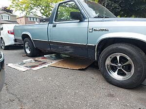

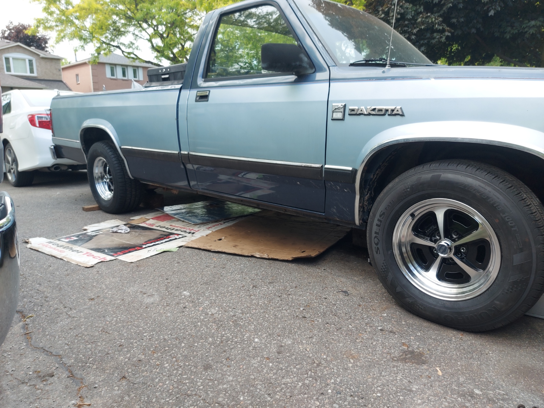

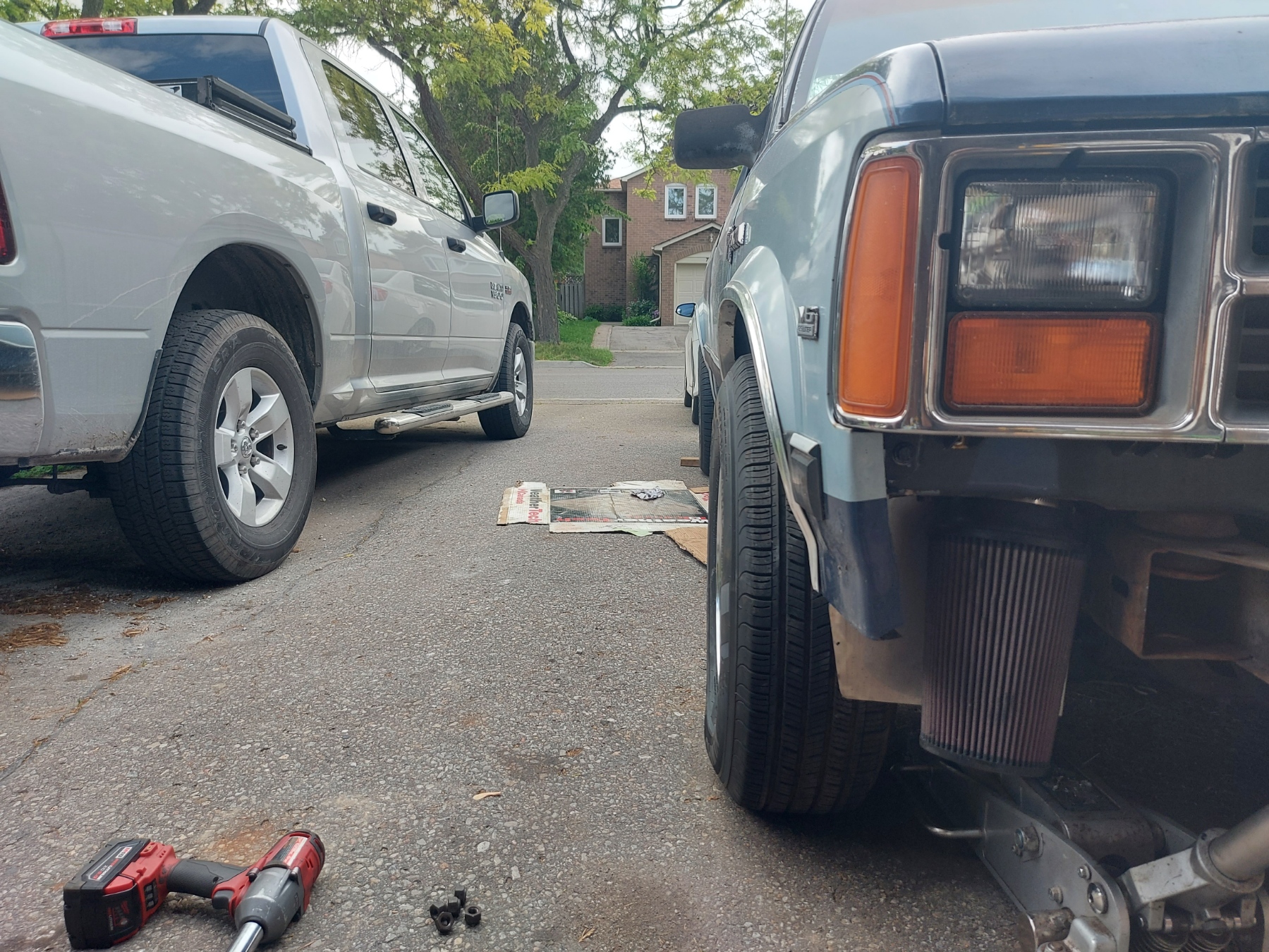

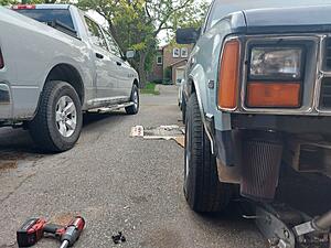

I have new rims and rear tires. I wanted to stay steel but they are hard to get and cost more than aluminum. I ended up with magnum 500 knock offs in cast aluminum. The back are 15X8 with 275/60R15 tires and the front are 15X7 with the factory size I had before. Back spacing is a challenge as there are not many options, there rear end being narrower fixed the back. The front stick out more than I wanted. I could not find matching rims with 8" width and 6" width other than Torq thrust knock offs.

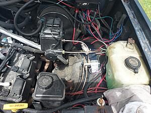

I got the brake lines done. I added line lock and an adjustable proportioning valve for the rear. I have an issue with the new drums as they get real tight when I bolt the wheel on. I put the old drums on for now. I'm going to get them turned and see if it fixes them.
