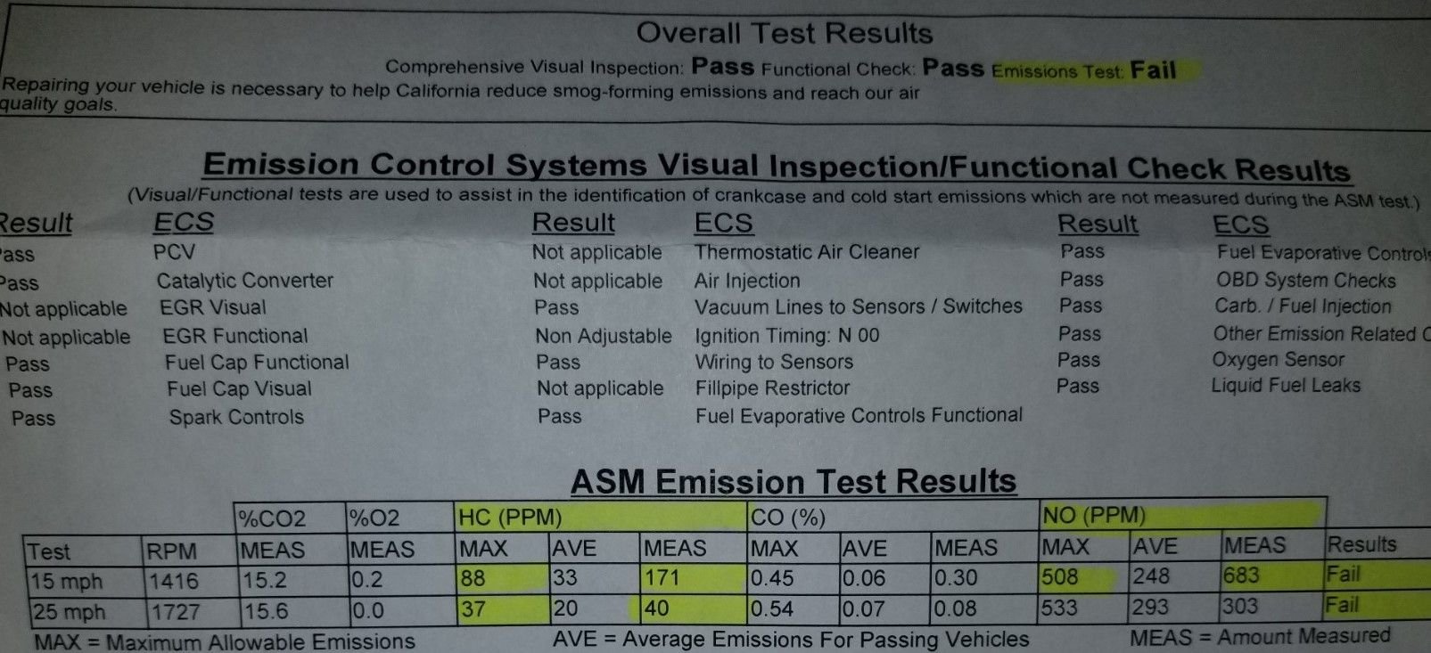

Results: failed for high HC and high NO
1st smog check fail

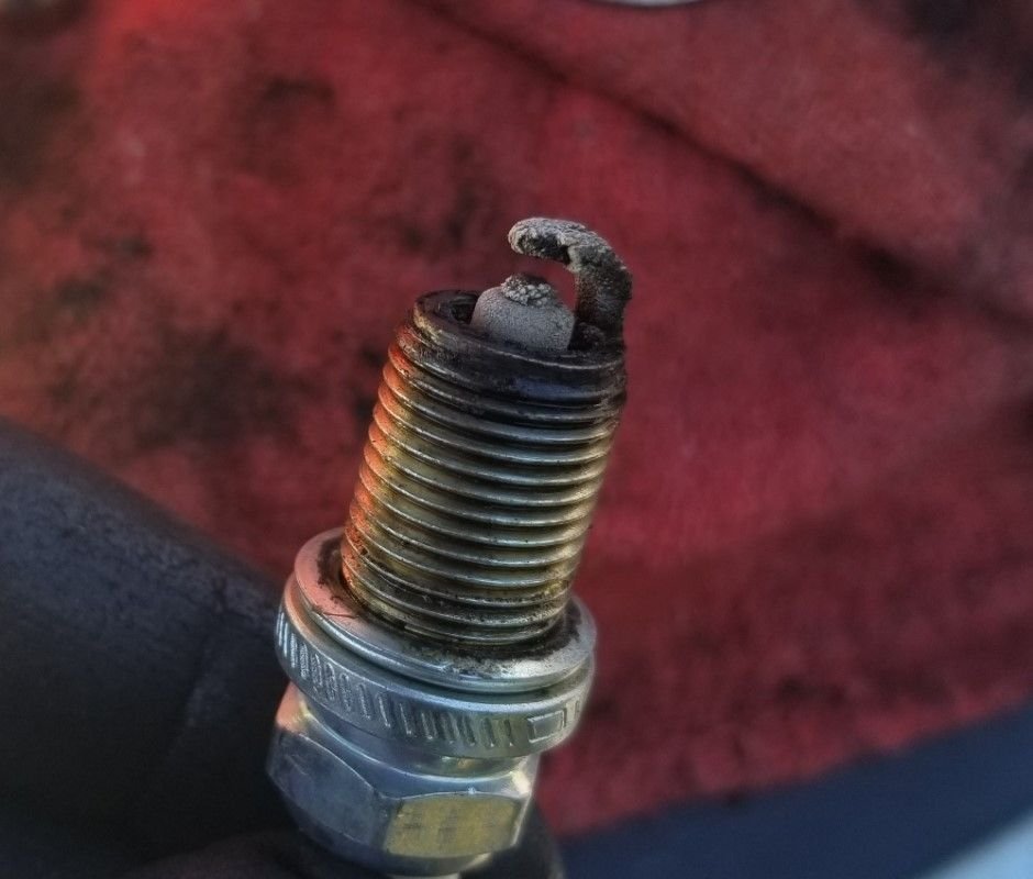

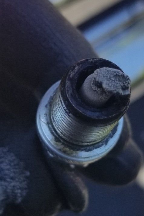

I did a full tune-up. Autolite plugs gapped to 0.35", wires, cap, rotor, air filter, PCV, crankcase breather element, and a fresh oil and filter change. Check out the pictures of the plugs. It's been two years since my last tune-up. White ashy deposits on the plugs look like we are running pretty lean. Ran the truck for about 100 miles before the next test.
Results: failed for high HC and high NO. Slightly lower numbers but not enough. At this point, I can't get much help as to why it is failing without paying a diagnostic fee of $300 for most shops. I called a few mechanics and one even said I should replace the engine because it is too old and worn out. I'm not giving up that easy. I also don't have the money to replace the engine.

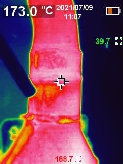

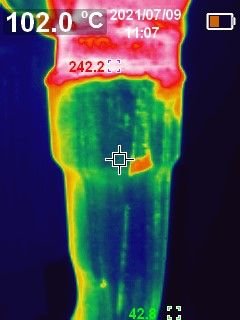

I read somewhere that if the catalytic converter is suspect then you can check the temperature before and after the cat to check its operation. Using an infrared camera temperature gun, I read the temperatures of the exhaust pipe before and after the cat. Since this is a catalyst I should see a hotter/higher temp after the cat than before the cat. Check the images out. I'm reading 173C before the cat and about 102C after. Well, would ya look at that? My cat is completely F'd. Check out these pictures.
Exhaust pipe before the cat. Engine side.
Exhaust pipe after the cat. Tailpipe side.

From various reading, this seems to be either a lean problem, or, and egr problem. Might verify egr is working properly, and the passages aren't clogged.
Looking at the temps on your cat though.... That ain't right, it should be HOTTER on the exhaust side of it. (not the engine side....)

I find walker 80906 as a California universal cat for a 95 Dakota.
The truck is burning something looking at the plug. Does not look lean to me. The plug is not read by the porcelain. That should always be white and clean.
I would be trying a new catalytic converter, aftermarket do not last long. Walker has 50 000mile warranty, so they last a bit longer.
