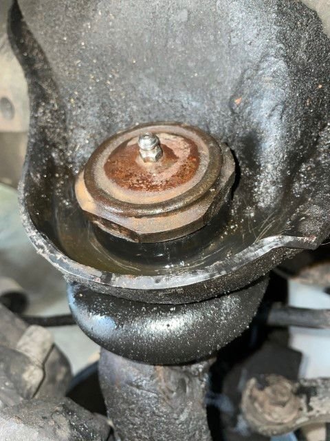

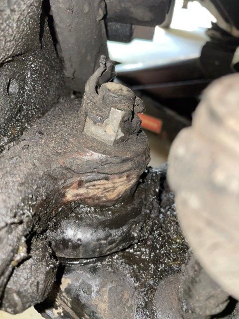

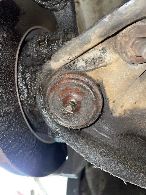

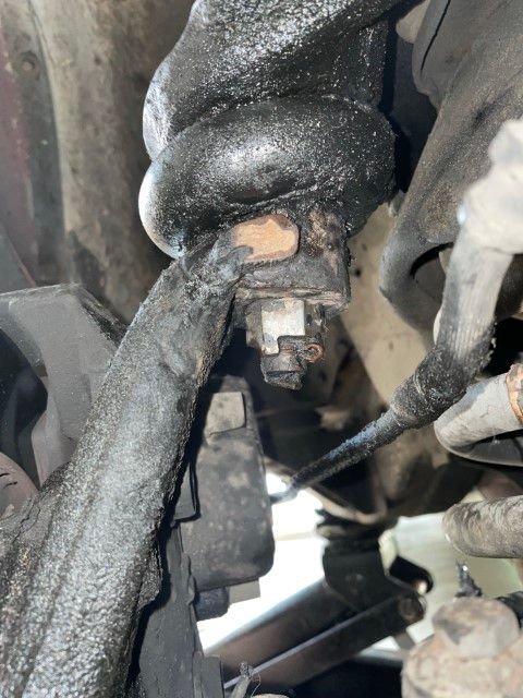

I guess I was thinking the ball joints on my '93 were riveted on. I looked at them yesterday and I am wrong. They are pressed in. I think they riveted them not long after the '93. Thinking there would be a snap ring somewhere (no, maybe not). Guess I'll have to get one of those press tools. Rent/borrow from parts store maybe. Probably wont have all the sizes I need and will have to MacGyver it. These jobs never seem to go without a hitch. I welcome any tips n tricks.
Upper Ball Joint:
Lower Ball Joint:

The uppers are NOT pressed in!
They are THREADED in!
If you just push them out, not only will you have a battle royal to get them out, but you'll strip out the control arms.
The LOWERS are pressed in; clean well, mine had a clip ring.
Here's the socket I bought AmazonSmile: Sunex 10214 2/9/64-Inch Ball Joint Socket : Automotive . It's 3/4 drive, so you'll need at least a 3/4 adapter, if not a 3/4" breaker bar.
The new ones will thread in also. However, several folks are having problems with the aftermarket ball joints being a bit loose. My ProForged and my last previoius Raybestos Professional Grades went right in slick as snot (Raybestos has dropped them; they now have to be bought as ACDelco Professional Grade.)
Proforged is now owned by Holley; they list 101-10127 for the uppers, and 101-10085 for the lowers. Parts are made in Taiwan, for what it's worth (personally, I think that beats China, but eh.)
The ACDelco parts were made by Spicer/DANA and are still, but Spicer doesn't sell them anymore as far as I can tell. Not at retail anyway.
Moog has two quality levels; skip the cheap Chinesium ones, get the higher quality and more expensive ones if you go Moog.
RwP
