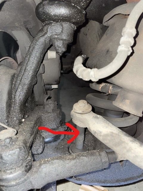

Ralph. how hard is it to replace that stabilizer bar while I have everything ripped up? Any issues getting it to line back up once I take it out? I call it a stabilizer bar but don't know what it's really called. It's that 8"ish bar that runs up and down (parallell with the coil spring). Center-bottom half of picture.
Also, do I need a spring compressor if I'm just changing out ball joints and tie rods?

Let me try that photo again with an arrow.

That's the anti-sway or stabilizer bar end link, yes. Replace that end link and consider new bushings.
Like most, if the front end is sitting level, AND you do it carefully, it's not hard.
If one wheel is up and one is down, you'll be cursing in multiple languages
What I did, was to start one side but leave it loose; then thread the other side through, tighten it, and go back and tighten the first one. (First one I just got the nut all the way on, no more).
This allowed me to shift it up and down to clear the second one.
I used the Energy Suspension greaseable bushings and ES end links - that was over 200,000 miles ago, and they're still in great shape.
(Then again, I lube them every time I do an oil and filter change - the bushings, that is.)
As to a spring compressor - not if you don't take the shock out and don't do the inner bushings. Leave the shock on to do the lower ball joint; then do the upper with the control arm in the truck. That way no need to worry.
