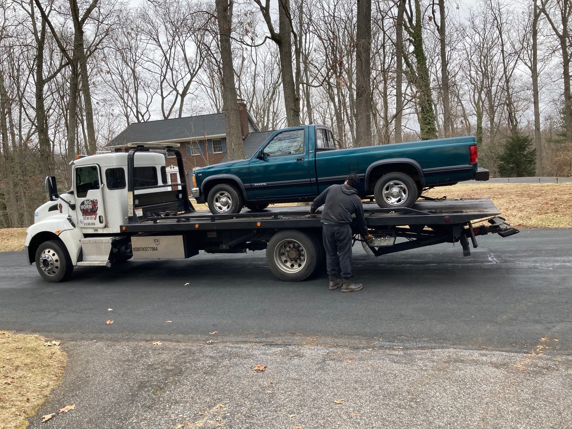

I had her towed to an "old school" mechanic in my area. He has worked on my father's cars, and I trust he will be able to figure it out. I am gonna kick myself if it is something simple that I overlooked--- but I just could not spend any more time and energy on trying to find the problem.
I will report back the solution, so that this thread can hopefully help somebody else on the forum.
